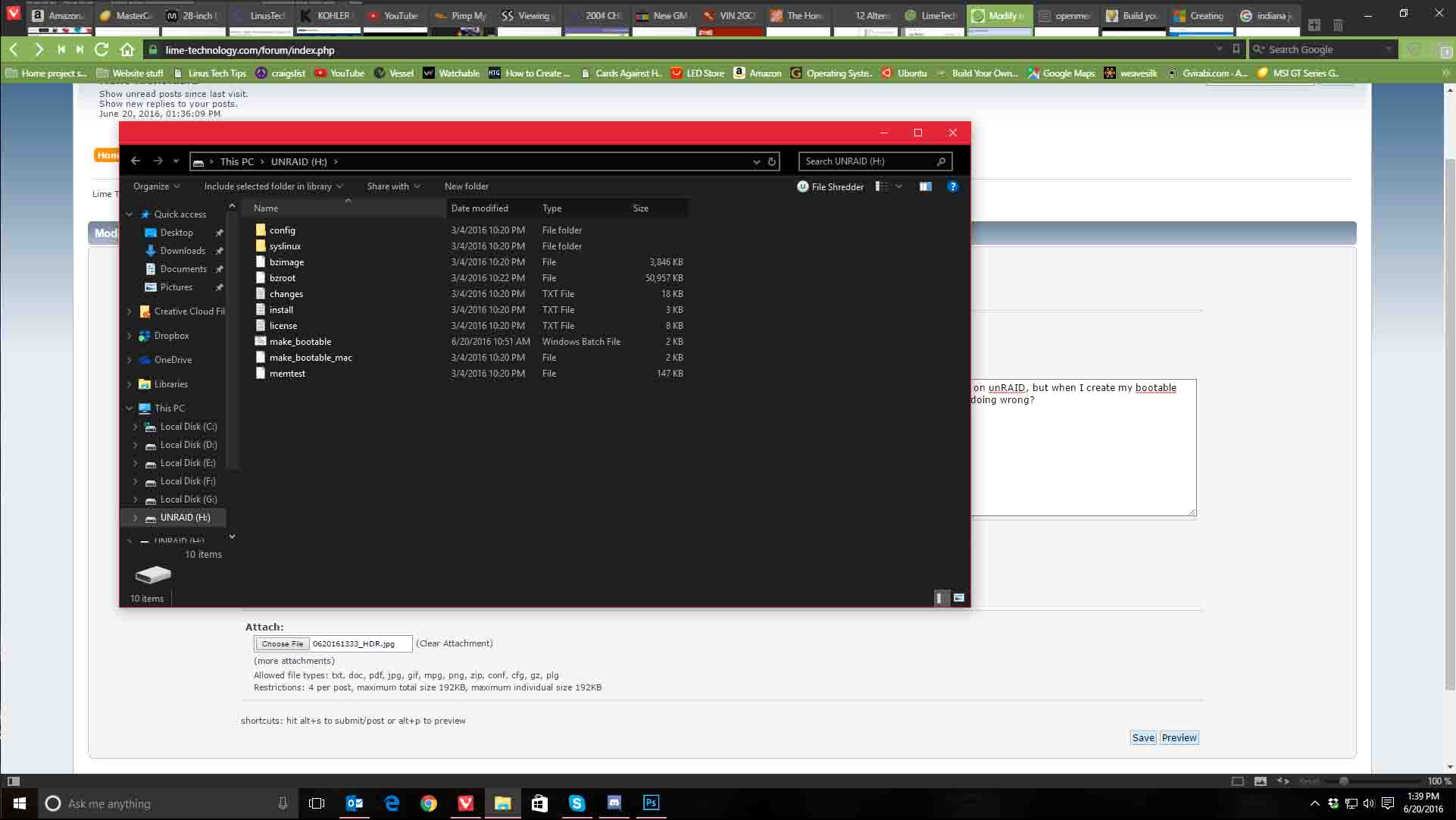

Hi. I have recently dedicated my old laptop to be my personal nas. I have tried many OSs like windows server, freenas, and a couple others. I have decided on unRAID, but when I create my bootable flash drive, my laptop goes right to the bios screen. When I try to boot from my desktop, it goes right to the unRAID screen. does anyone know what I'm doing wrong? Attached is a picture of the files that are on my flash drive.
Well have you run the make bootable bat file?
And is your laptop configred to boot from usb?
I have already made the flash drive bootable, am I supposed to delete the file when Im done with it? I have also already set my laptop to boot from it. I'll post a picture of my bios screen.
