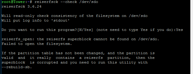

I ran the reiserfsck --check /dev/sdo and attached the results
Thanks, in advance for any assistance provided!!!!
You need to run reiserfsck on the sdo1 partition, not the sdo device. Try again and post the results.

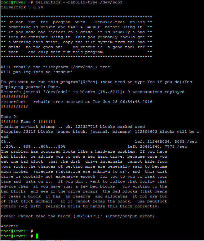

You have to run reiserfsck with the --rebuild-tree option.
reiserfsck --rebuild-tree /dev/sdo1

Ok it's running..  Looks like it will take awhile, will report results after I return from work.
Looks like it aborted due to I/O error from a bad block.  Results attached :'(

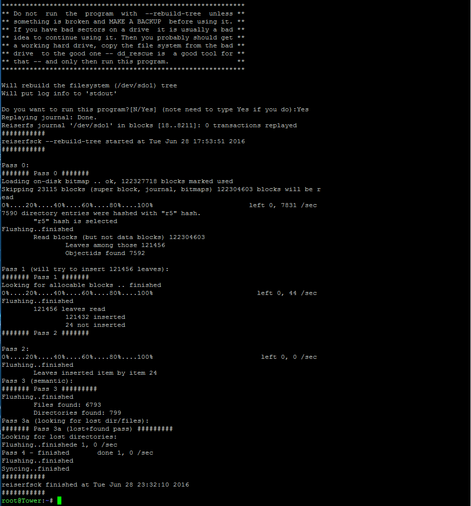

2nd try looks like it finished correctly.  Results posted, but not sure how to proceed from here.
Copy all the data you can from that disk to array, check for a lost+found folder, there could be some data there.
ok....  I figured that, but paranoia had me wait for confirmation and was amazed when the drive mounted with UD after so many times the mount option failed.

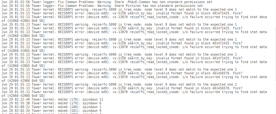

Fired up MC and copied all data from the old disk7 to the new disk7, however another problem still exists with drive9. The "Fix Common Problems" plug-in shows drive9 mounted as read-only, and my syslog shows reseirfs warnings/errors on Device md9.  The Syslog showing this information is attached.  So based upon your earlier conclusions and these errors, I'm thinking that I will have to fire up the New Config utility and rebuild my Parity drive.  I compared the files on the new Drive9 with the old Drive9 and they all seem to be in place.  Additionally, the USED/FREE percentage on the new drive9 is identical to the old.

Disk9 rebuild had errors, so it's normal to have file system issues, besides there are almost certainly corrupt files, they look the same and occupy the same space but can be corrupt.
By using a file compare util I meant to use one that compares files on a byte level, but since you have the old disk I would format disk9 and copy all data from the old disk.
Simplest way to format is to stop the array, click on disk9, change filesystem to XFS, start array, disk 9 will appear as unmontable, click format.
You can leave it XFS, but if you want reiser just change fs back to reiser and reformat, then copy all data from old disk9.
PArity will remain valid.
