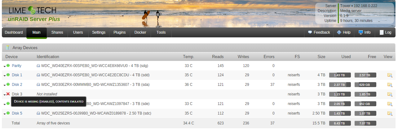

It should rebuild whatever files are currently showing for that emulated disk. Can you browse to that disk# and see all your files? Start the array with that disk unassigned and post a screenshot of the main GUI.
Thanks for the reply
Yes can browse to it when started)
See attached image.
Yes, it will rebuild the contents.  Assign the disk and start the array ... it will rebuild the contents onto the drive.
You don't want to delay doing this ... you're running "at risk" until it's done.    i.e. if any other disk fails you'll lose data.
