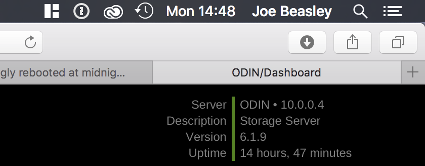

Time is set correctly, and it was actually the system uptime which first led me to believe it was a shutdown - as the uptime is 14 hours and 47 mins, and the time is 14:48 (see attached).
EDIT: Timezone was set incorrectly (my mistake), was set to Pacific not UK.

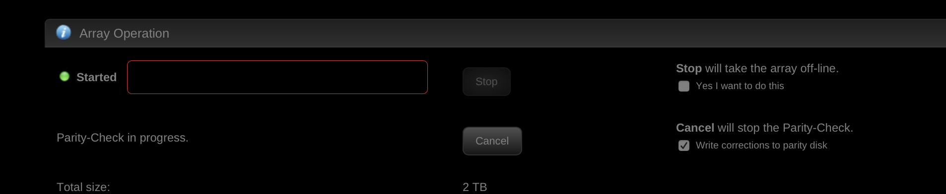

In the red area attached, written in orange. When I started the array it immediately started a parity check which is still ongoing.
And there is no parity check in your syslog either.

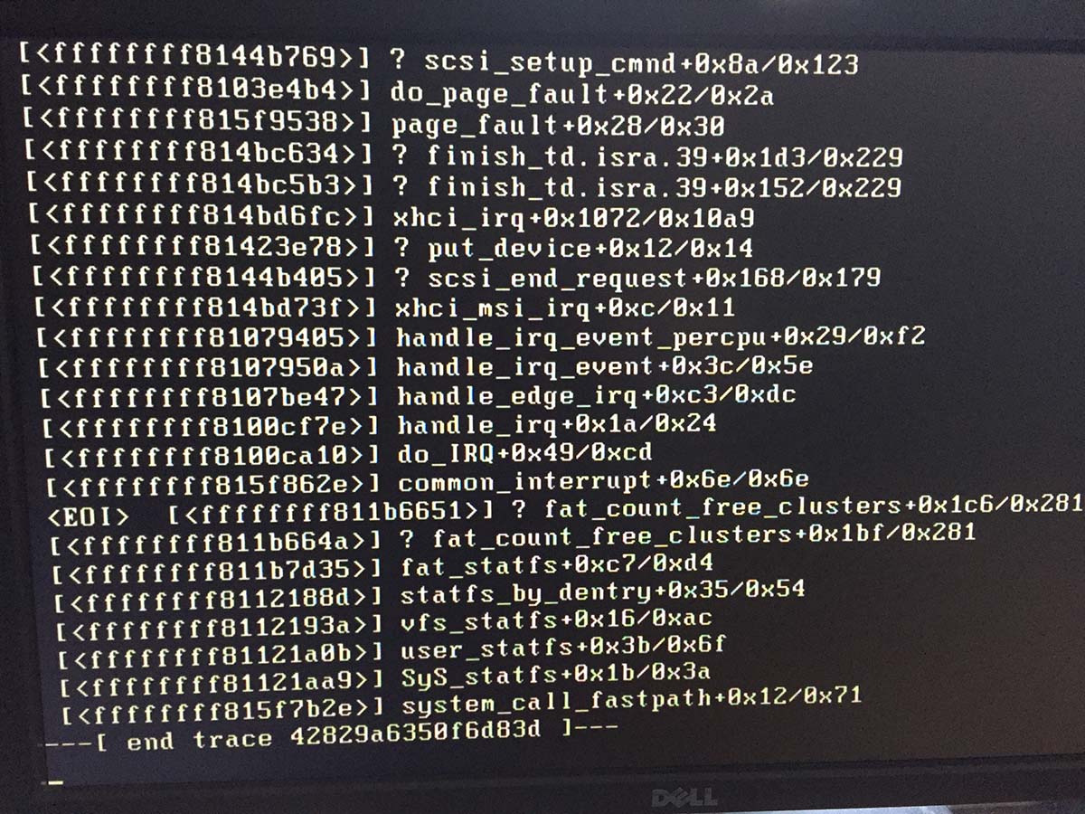

Today I removed all the drives (I'm getting concerned about data integrity now) and ran memtest for over an hour with no faults. My next thought was to power up the unit and get the log files off with the drives still removed and then turn it off again while I go through them. However the machine thew a kernel panic as soon as it started to boot and hung. (See attachment). While checking the BIOS i also note than auto restart on power failure is actually off, meaning the other instances where this happened is even more peculiar as the machine decidedly did not lose power, or else the machine would have still be powered off when I noticed.
I'm at a bit of a loss now, I noticed the error message mentions FAT, could there be a problem with the USB stick?
