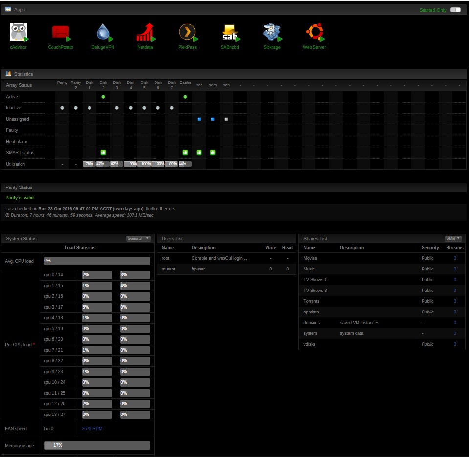

System now has 1 x Dedicated GPU for VM use running at x8
1 x GPU assigned to unraid running off the x1 slot
2 x IBM 1015 HBA cards
With lots of room to move on the performance side of things.
