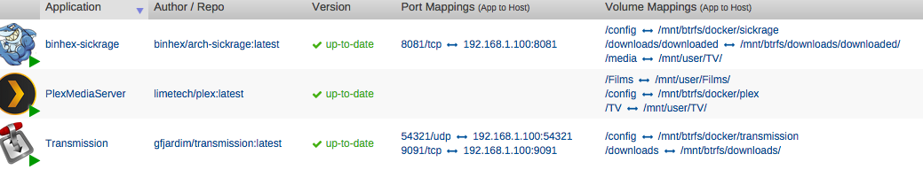

Basically mapping /mnt/user/TV to /TV and /mnt/user/Films to /Films

Question:  On your configs, where are you getting /mnt/btrfs/... from?
Unless you're mounting that manually, or set it up with an old version of unassigned devices, that mount point doesn't exist, and will wind up being stored in RAM.  Should be something like /mnt/user/docker/... under normal circumstances
Hi yeah,
Its a mounted 1.6TB SSD
How are you mounting it? Which version of unRAID?

In that case, under any version of unRaid, you have to stop and restart the ENTIRE docker service via settings - docker on any boot / reboot as it will not properly recognize the /config folder since its not local to the array.  (If it was mounted in /mnt/disks, then you could use one of the "slave" modes to accomplish this instead)
The config directory is fine.. its the films and tv I can't see.
I stop and restart docker at boot time vi the go file, I do sme tweaking to push sickrage and transmission out my vpn network, dual hosted unraid.. anyway I digress.
So it gets stranger, sickrage is the same too, under /media to tv programs. /mnt/user/TV it too was empty, so I changed it to /mnt
