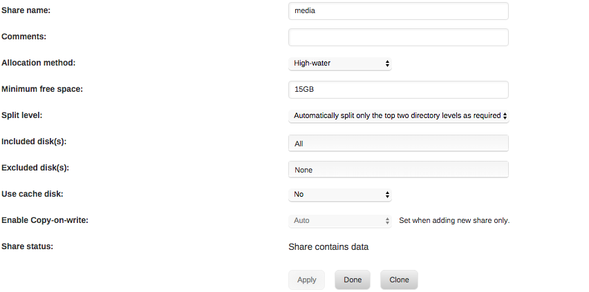

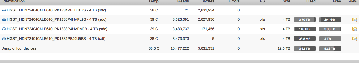

So long story short. The other day I logged on to unRAID to find one of my drives was unmountable. Me being stupid, messed around with new configuration settings and screwed up the array. I ended up reformatting my data drives and kept my cache drive intact. My cache drive stores docker app configurations. I initiated the transfer of my data to unRAID and this morning I come to find that highwater allocation is not distributing data across the drives. It added a bit of data to disk 2, but not much. What exactly happened? Was I supposed to reset some kind of setting before adding data back to the drive?

I did learn that split level take precedence in my search of trying to figure out the issues. When I initially set it up the server with split level 2 my data had no issue being allocated among the drives. Anyways, when adding back my data via ftp, the path I used was /mnt/user/media(share)/shows/. Was this an incorrect path?

It still confuses the hell out of me too. The only reason I went with split level 2 was because of a discussion I had with an individual on reddit. Now I am wondering if I have been using the correct path to add my data to the array....
So if I were to switch to split level 3, will it retroactively redistribute the data? Or is it only for new data?
Also, is it common to for split levels to fill a drive before utilizing other drives?

happens easily if you make it too restrictive.
Okay, so what exactly was done which made it too restrictive? Was it because I choose split level 2?
yes - a level of 2 means only the folder corresponding to the share name and the first subfolder level under that can span drives.    Any further levels of sub-folder are constrained to the drive where they are first created.
