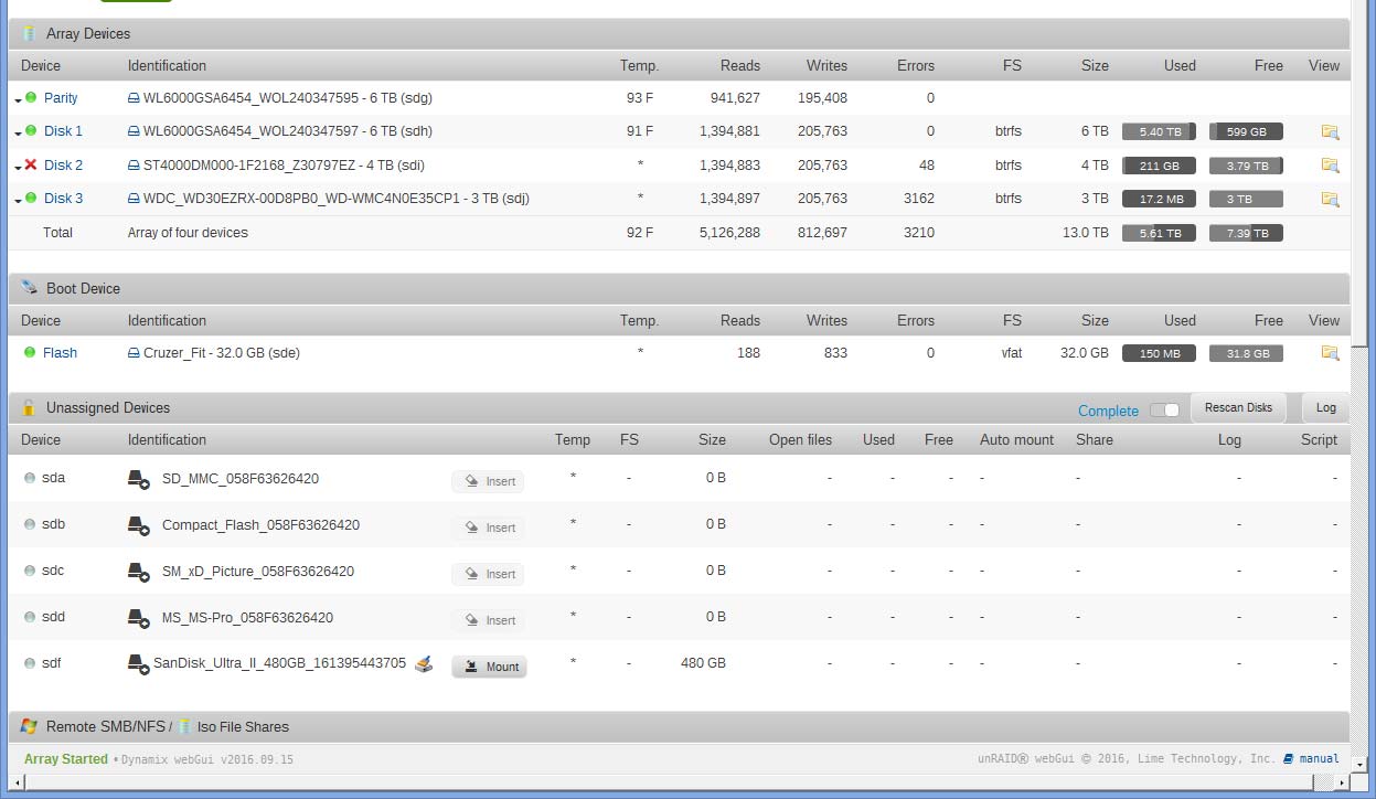

Rather than do the new config, I decided to just stop the array and add the dropped disk back in and see what happened.
Parity stopped claiming that it was aborted by the user but I didn't stop it. Disk 2 shows a red X but still shows as installed. Disk 3 shows as green but was full of errors.

Post a screenshot of Main.

Attached screenshot.
