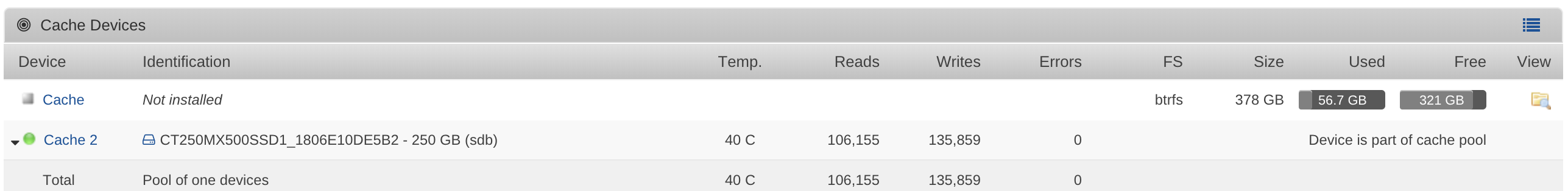

Sorry, one last question. At what point should I physically remove the bad drive?

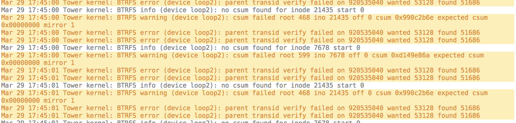

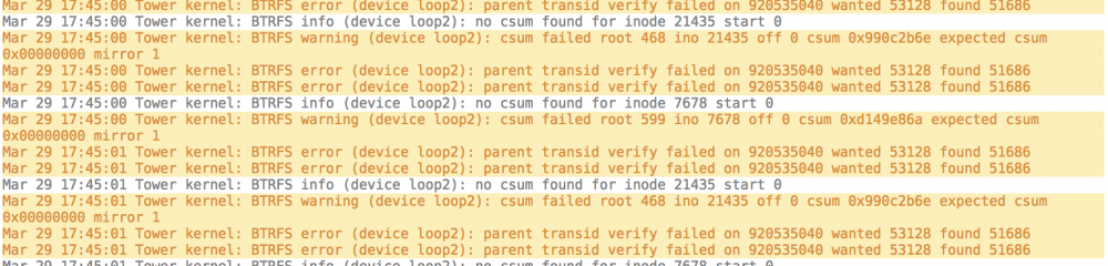

So went through the steps and getting some weird stuff now. 5abd88705c988_ScreenShot2018-03-29at5_42_58PM.thumb.png.70cf41383abd57fc24a0dce2567fb48e.png
When the stop array button is available.
That's likely a corrupt docker image, would need the diags to confirm, if yes just delete and recreate.
