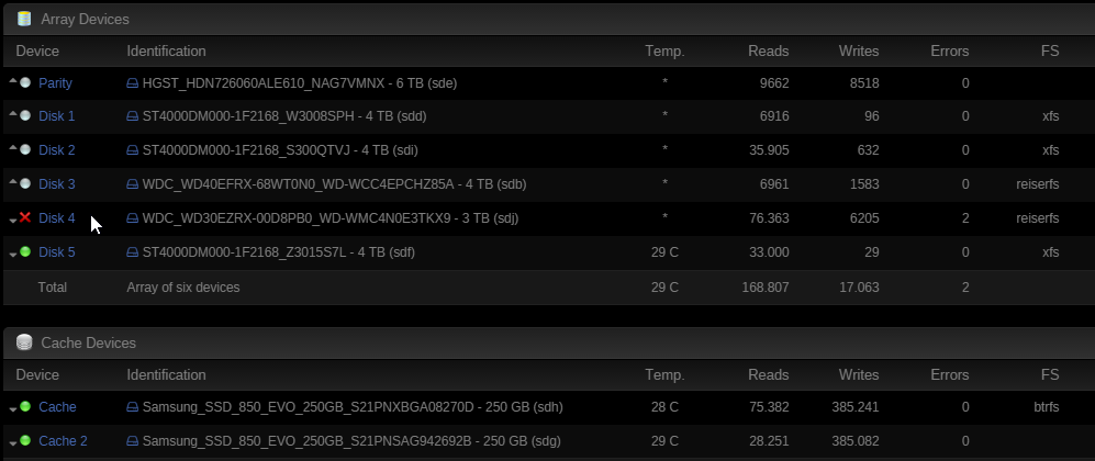

One of my drives was disabled today. Looking at the log, I'm not sure what this might be. GUI reports "only" 2 read errors. I'm running 6.2.1 and can't update to 6.2.2 right now due to ongoing preclearing of new disk.
Can anyone take a look at the log and perhaps provide some input? As this is happening while preclearing a new Toshiba X300 6TB drive, I am wondering if my Sea Sonic G 360 is not providing enough amps and the drive drops out.
There's also some - perhaps - unrelated system messages about "program smartctl is using a deprecated SCSI ioctl, please convert it to SG_IO"
Have attached log excerpt and overview of drives in system.

unRAID will only disable a disk when a write to it fails:
Oct 24 12:50:38 Tower kernel: md: disk4 write error, sector=2320118744
SMART for the disabled disk
Oct 23 14:57:02 Tower kernel: md: import disk4: (sdj) WDC_WD30EZRX-00D8PB0_WD-WMC4N0E3TKX9 size: 2930266532
does not appear in the diagnostics.
Is this disk on a motherboard port?
unRAID is currently emulating the disk using parity and all the other disks. All reads and all writes to the disk are actually being calculated from all the other array disks, and the actual disabled disk is not being used. Even if you haven't written anything else to the disk, the write that failed means the disk is out-of-sync. The failed write and any subsequent writes to the disk are in the array because parity was updated, but they are not on the disk. So the disk contents are invalid now. To enable the disk again, you must rebuild it.
If we could see the disk in the diagnostics, then we could decide whether to rebuild to the same disk, or to replace it.
Check connections, power and SATA, then post another diagnostic.

SMART looks OK. You can try to rebuild to the same disk. Or replace with the newly precleared 6TB if you want. You should get the array stable one way or another before trying to add a disk to a new slot.

Format is NEVER part of a rebuild. If you format the only thing it will be able to rebuild is a formatted disk.
Format means "write an empty filesystem to this disk". That is what it has always meant in every operating system you have ever used. unRAID treats this write just like any other, by updating parity. So after the format you will be able to rebuild an empty filesystem, not what you want!
Stop array, unassign disk, start array. This will make unRAID forget about the disk assignment. Then stop array, reassign disk, start array to rebuild.
