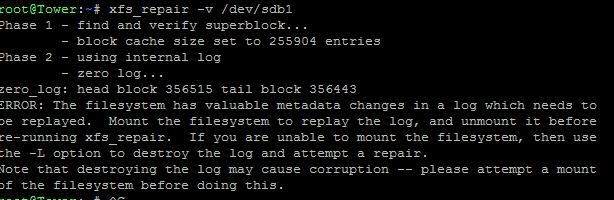

Not sure if this helps move in a direction to fix but when I select disk shares to yes they all show up as exportable shares.
I can access all five of my disks without a password but when I try to access my cache drive if prompts for a password an will not allow me to access.
The cache drive is where all my app data is and docker image
When i run the command I get the attached pic
Cache still mounted on previous diags, so try starting the array in normal mode, if it mounts stop and re-start in maintenance mode to rerun xfs_repair, if it doesn't mount using -L is your only option, usually there's no or very little data loss.

Well I went ahead and used the xfs_repair -L /dev/sdb1
The Shares seem to be back but there seems to be some issues with dockers so going to delete docker.img and go from there

1.  What pointed you to tell me to use the xfs_repair -v /dev/sdb1 command?
2.  How do I tell how much data was lost if any using the -L
3.  How do i stop this from happening again
Syslog shows the filesystem issues, check the lost+found folder, avoid unclean shutdowns and get a UPS if you don't have one.
