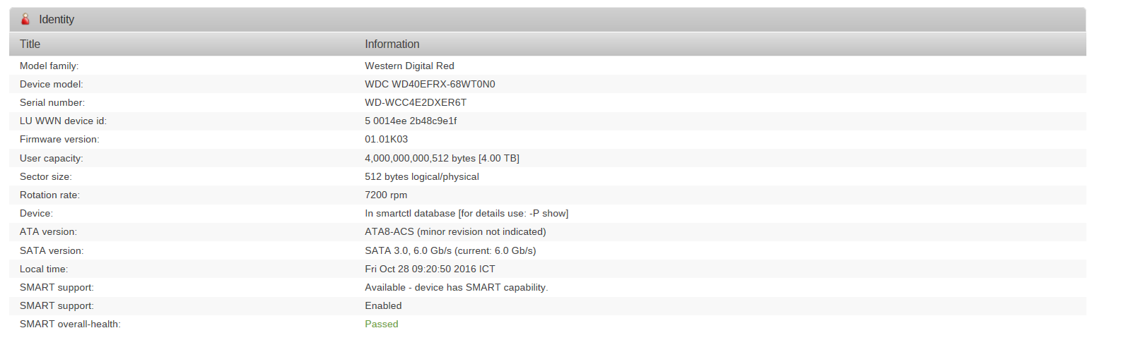

I just notice that one of my 4TB WD RED (few years old) has different size
It's the one that I paid $70 cheaper (It's already $20 cheaper than other local shop and I won $50 voucher for that shop)
normal WD RED = 4,000,787,030,016
suspected OEM WD RED = 4,000,000,000,512

Fundamentally it doesn't matter => as long as you're not using this drive as a parity drive, the few extra bytes it's missing are irrelevant.
If you DO want to restore it to the max size, I'd use the free HDAT2 utility.
http://www.hdat2.com/
Just create a bootable CD or floppy (if you have one) and you can easily remove any DCO and/or HPA from the disk, restoring it to its full size.    But as I noted, there's really not much reason to do this.
