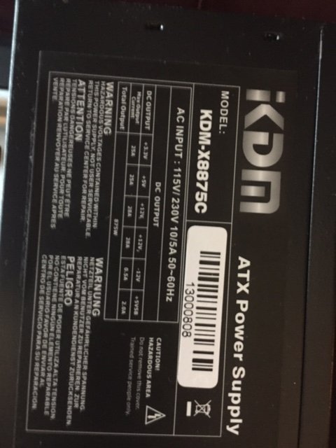

You posted this last in V5 support. I moved it and merged it with your previous thread since it had some posts that are probably still relevant. What is the exact model of your power supply?
Thanks for organizing the thread. I'm kinda new at this. The power supply is KDM-X8875C. 875 Watt ATX Supply. I included a picture of the specs.
