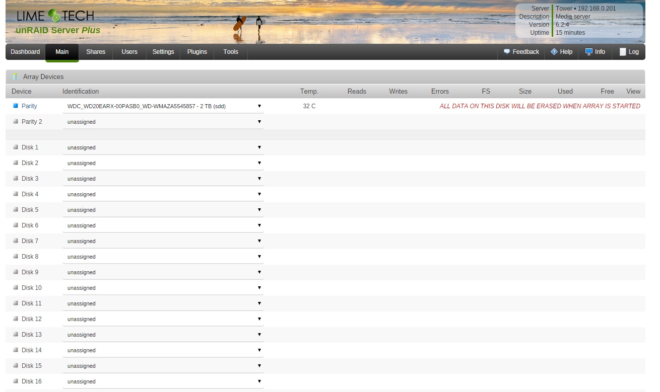

Question I have (before I do something stupid). I have serial numbers of all drives and their placements from old setup and I am very careful to assign parity to correct location, but when I picked the parity drive to assign to the parity slot I saw "ALL DATA ON THIS DISK WILL BE ERASED WHEN ARRAY IS STARTED"....I haven't touched a thing and came here first...

Did clean power down (without assigning anything), took USB stick back to my other PC and did like you said. I copied (and overwrite) whole config folder. Still same thing as in the attached picture "ALL DATA ON THIS DISK WILL BE ERASED WHEN ARRAY IS STARTED"...? I tried selecting Parity 1 and parity 2 but it was same for both. Is it because 6.1.6 only had 1 parity option and now this has 2?
I am just afraid to lose data. What did I do wrong? and how to get myself out of this mess I caused myself?

That's just a warning so users make sure they're not assigning a data disk to the parity slot.
Make sure your parity is assigned to the first parity slot, it won't be valid as parity2, before starting the array check the box "parity is already valid" to avoid a parity sync.
