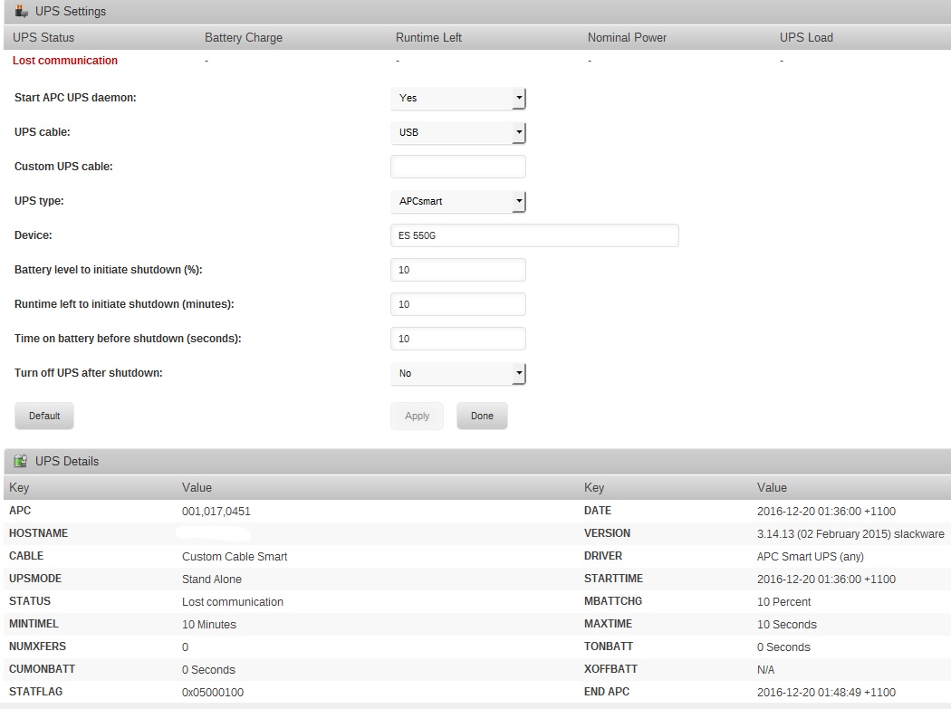

the settings on the UPS pge are attached, but are pretty standard APC UPS.

Try changing where it says: UPS Type and you have APCSmart, see if you can change that to USB and see what happens.
