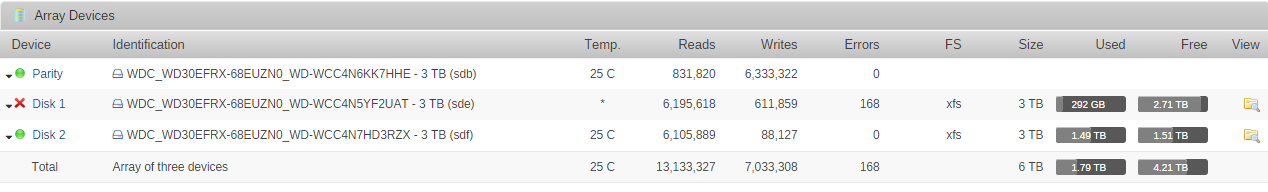

Hello everyone! I'm having an issue with one of my drives. It keeps showing as disabled, but I know the drive is good.
Could this be caused by a faulty port on the motherboard? I plan to pull the PC apart later and switch ports. I just wanted to know if anyone has had this issue before.

Even if the drive is good it will have to be rebuilt. That is how you enable a disk again.
unRAID disables a disk when a write to it fails. It could be that a faulty connection is to blame, but even if you fix that unRAID will not use the disk again until it is rebuilt because the drive contents are invalid. The write that failed is in the parity array, as well as any writes that occurred after the disk was disabled. The valid data for the disk is in the array, but not on the disk, so it must be rebuilt.

What do I do if I get a red X next to a hard disk?
SMART for 2UAT looks OK. Check connections, power and SATA, both ends, then you can try to rebuild to the same disk. Have you read the wiki I linked?
