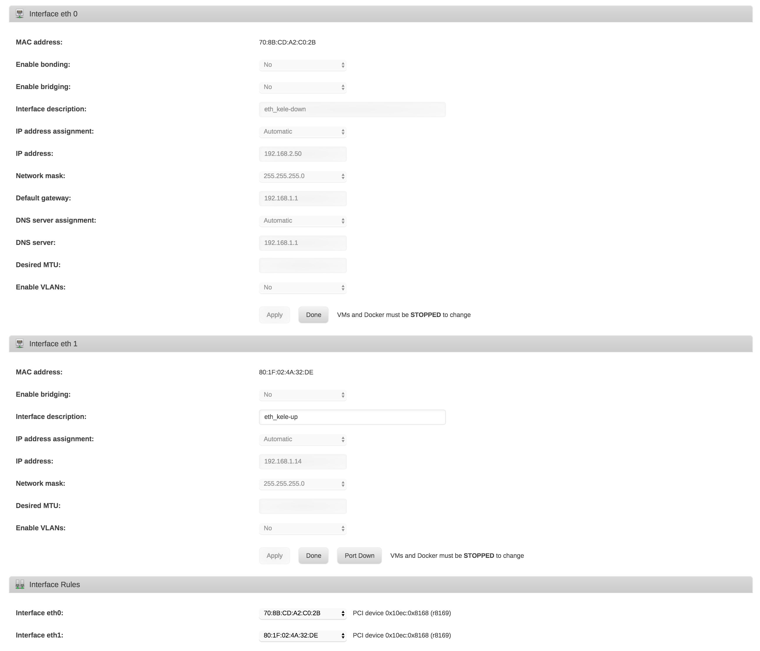

So this is how i set it up,
disabled bonding and bridging,
both NIC's having automatic DHCP assignment from router.
By the way, you do not have it set up as the link you referenced ( https://drive.google.com/file/d/0B0DLkIfwhVMESHN4d0pGUEk2T0U/view  ).  Notice the difference in the third group  (192.168.X.xxx) in the figure from the actual settings on your unRAID Ethernet interfaces.  I suspect that problems will crop up down the road.  (Making the change to that setting will require that you reconfigure one of the routers!)
You might want to look at making one of your routers act as a Network Access Point rather than a router as SOME routers have that capability.  Google "network access point vs wireless router" for more information.
