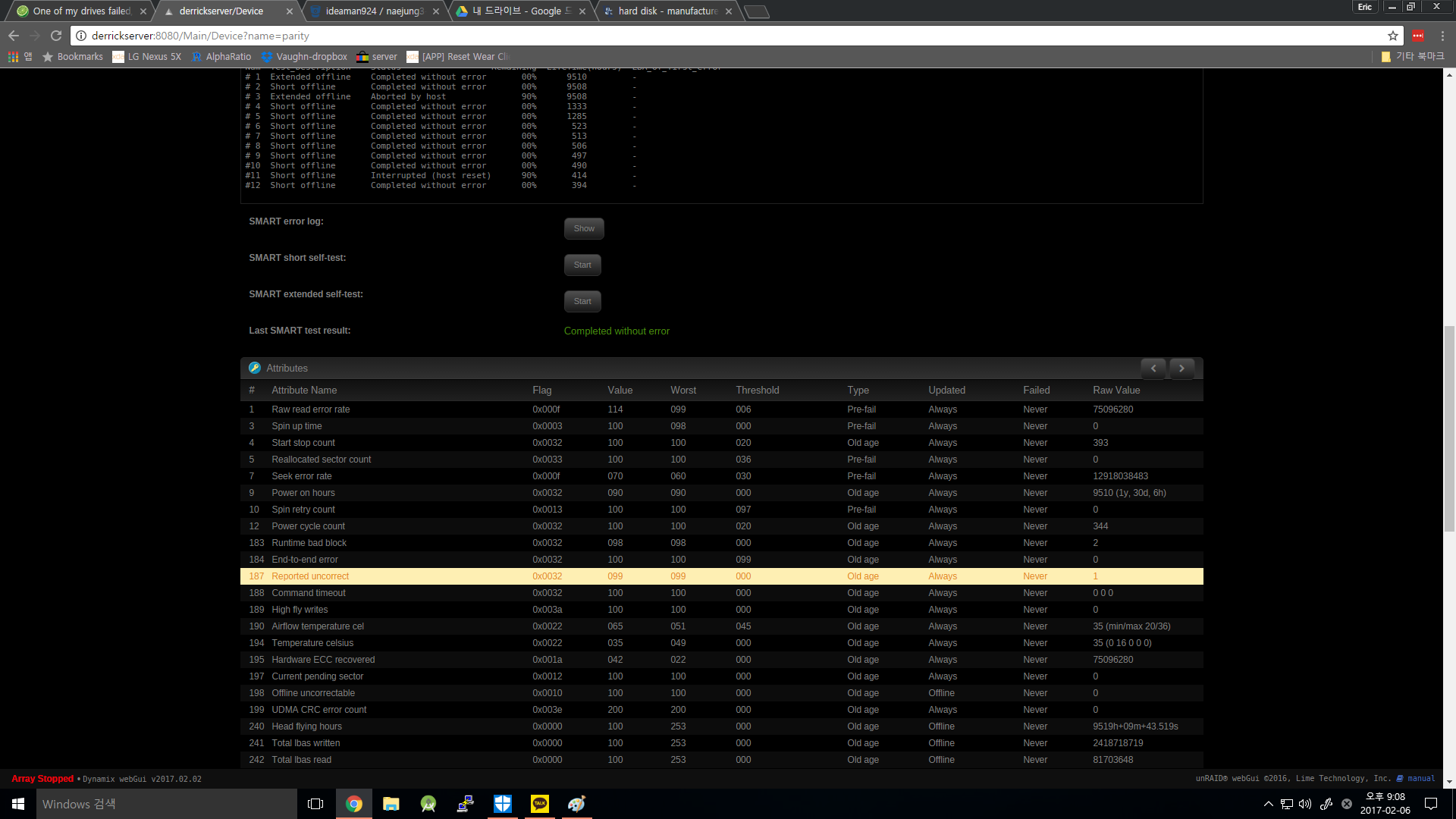

image1.png shows what it's like right now. There's a X next to parity, the drive that has failed.
image2.png shows the dashboard. As you can see, the parity drive is 'faulty' and does not work.
image3.png shows the SMART status. Check out the parts I put in red. The raw value is completely messed up.
Looking at the SMART report, I'm 70% sure this drive is dead, but I'd like to resurrect it for now so I have a chance to buy another drive.

Run an extended SMART test on the parity disk.
Thanks @johnnie.black, sorry I'm a bit late but the test took over an hour. It passed.
Does this mean that it was a temporary head crash and all is well?

I'm not so crazy about the runtime_bad_blocks and the reported_uncorrect.
I see no sign of cabling issues, which is good!
Keep a watchful eye for these values to increase. If they do I might consider a swap out.

Yeah, it's good that it passed the extenden SMART test, but both the SMART attributes and this:
I was working on my computer this morning when I heard a lot of sharp 'clicks' coming from the server.
make me think you may have more issues soon, if it happen replace it.
This.
Hard drive repeated clicking is typically one of two things. Bad power (PSU or cabling) or impending catastrophic HDD failure. BTW, bad power CAN cause the HDD total failure.
