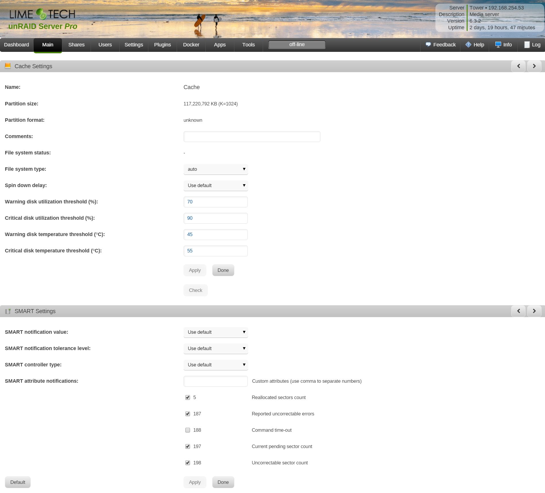

Post your diagnostics, Tools -> Diagnostics
hmmm, never seen this before:
cacheFsType="fuseblk"
With the array stopped, go to the main page, click on the cache disk take a screenshot of current setting for "file system type", then change it to "auto", start array, if it still doesn't mount post new diagnostics.
Edited by johnnie.black
10 minutes ago, johnnie.black said:
hum, never seen this before:
The File System was already set to Auto.
When I initially set it up I pluged this old 120GB SSD thinking it would speed up my Plex transcoding or whatever. I haven't messed with it besides assigning it as a Cache drive.

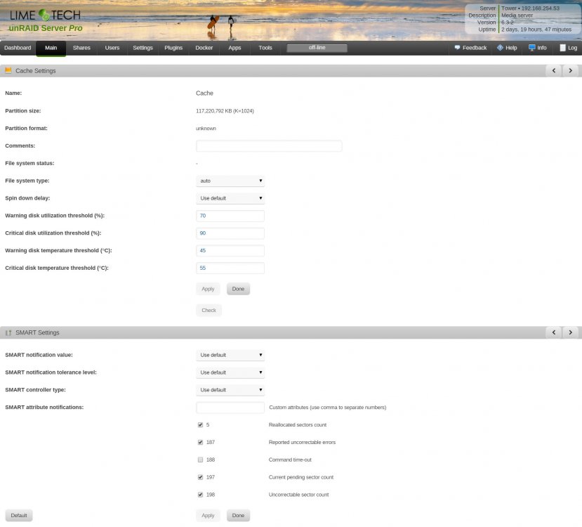

Change it to any of the other settings, click apply, then back to auto, and apply again.
Still comes up as Unmountable.
Should I try starting array with it in something other then auto then stop and revert it back again?
tower-diagnostics-20170221-1035.zip
That fixed the setting:
cacheFsType="auto"
Now it's trying to mount correctly but it looks like there's no file system on the cache device, if it was empty probably best to just format it, whatever happened to change that setting may have damage the cache filesystem.
