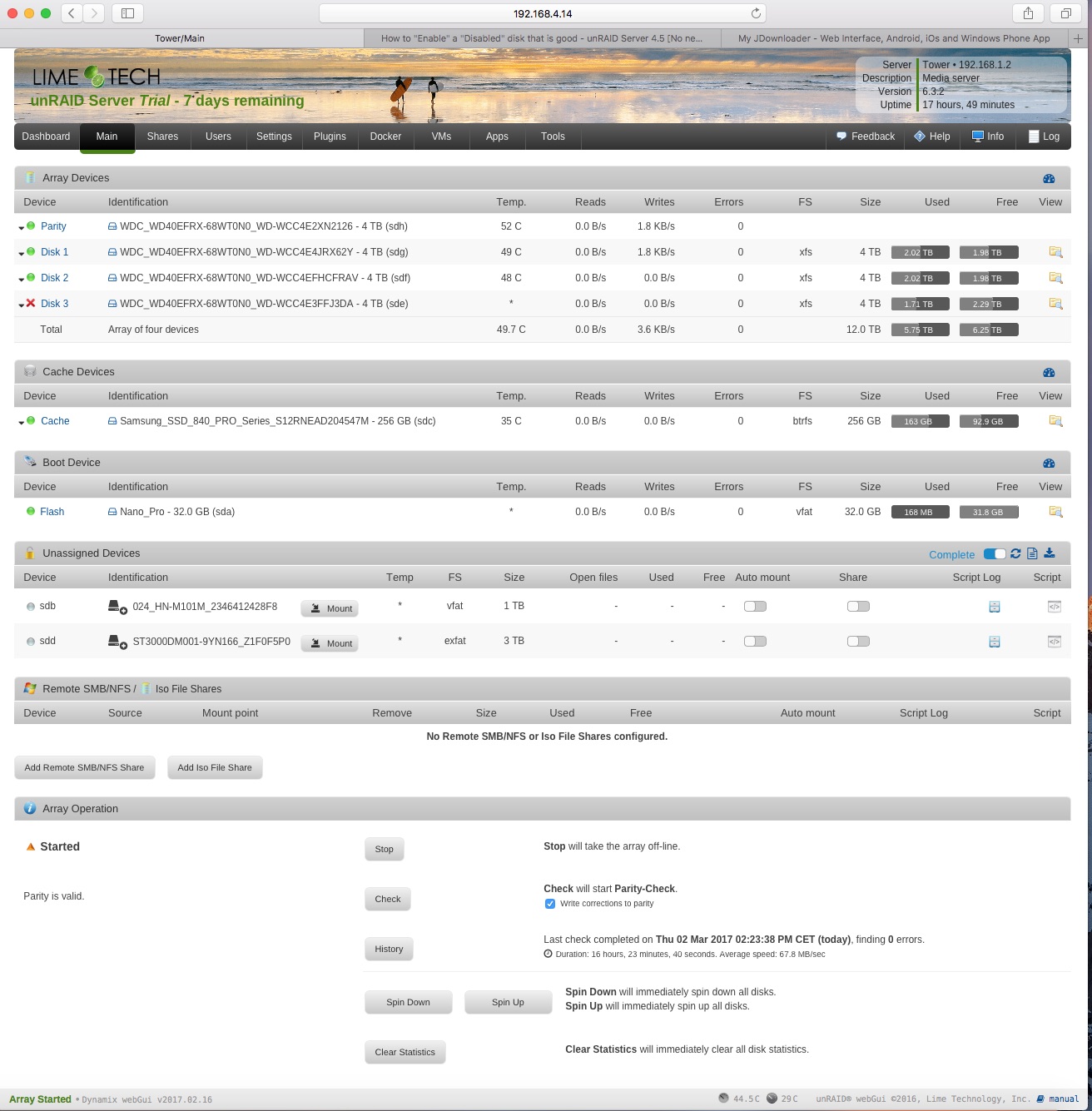

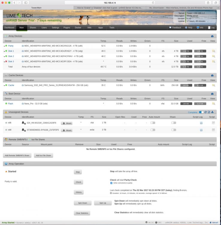

Last night it came out a red X mark next to the 3rd hard drive -> Device is disabled, contents emulated.
How can I fix? thanks bye..
I attach screenshots

SMART for all array disks looks OK. You can try to rebuild the disk to itself.
Stop.
Unassign disk
Start.
Stop again.
Reassign disk.
Start to rebuild.

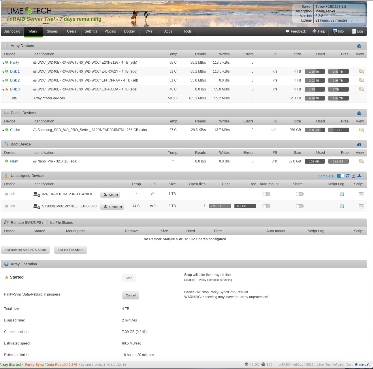

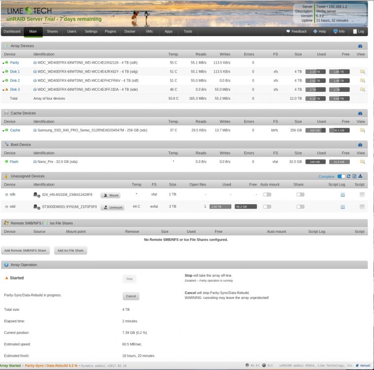

Ok I tried with your system!
It seems to work, however, it tells me 19 hours! :(
Thanks for your help! bye
Total size: 4 TB
Elapsed time: less than a minute
Current position: 2.54 GB (0.1 %)
Estimated speed: 61.0 MB/sec
Estimated finish: 18 hours, 12 minutes
