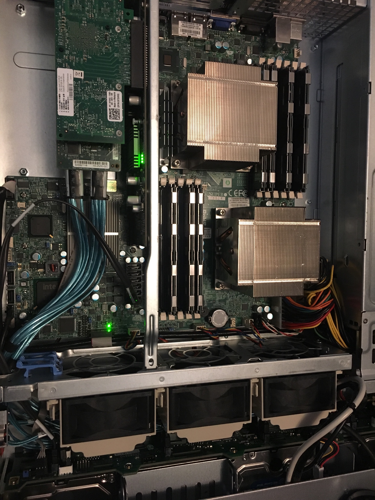

My specs are below. I attached my raid array config as well.
Server Chassis/ Case
Supermicro 2u SC825TQ-R720UB
Back Plane
BPN-SAS-825TQ (8x 3.5" SAS/SATA Hot-swappable Drive Bays)
Motherboard
X8DTU-F Motherboard
CPU Processor
Dual Intel Xeon E5645 Six core
RAM Memory
64GB DDR3 ECC REG Memory (8 x 8GB)
Hard Drives/ Caddies
None. come with 8 3.5" Caddies
RAID Controller
8 Ports are connected to LSI 9211-8i 6GB/S HBA JBOD IT-MODE controller
IPMI Management
Onboard dedicate IPMI 2.0 Management port
Intel X520-DA2 dual 10GB SFP+ (no optics) Expansion Card PCI-E Installed
Onboard Dual 1GBE NICS
Power Supply
Dual Supermicro 720W REDUNDANT POWER SUPPLYPWS-721P-1R Gold Certified
RAILS
come with Rail kit
EXTRA
Slim DVD Rom drive, SuperMicro RSC-R2UU-UA3E8+ Left Slot Riser Card PCI Express x8

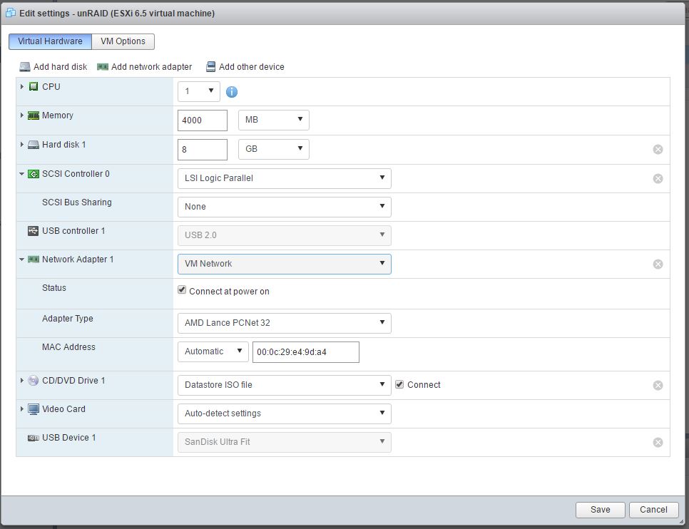

I already downloaded  ESXI Version 6 update 2 and created a  bootable esxi 8gb  flash drive
You mentioned I would have to connect additional hdd/ssd drives to my internal sata ports ,correct ? Is this for the passthrough or is this for the datastore ?
I'm googling and using the ATLAS article as a  base ,but I'm still trying to prepare for everything .
Thanks. :)

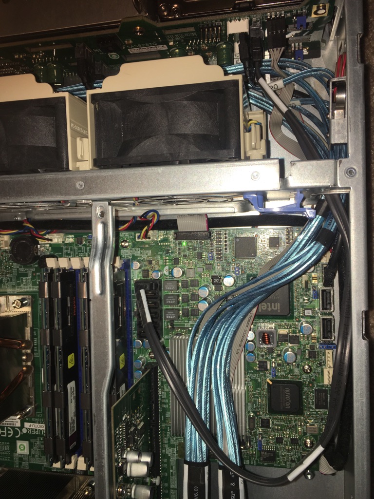

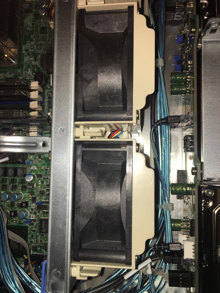

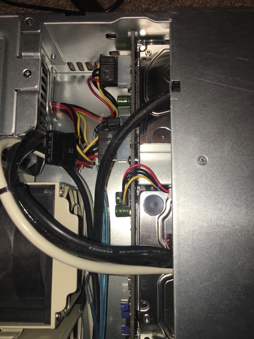

So this might sound like a stupid question . It's in regards to power.
I know one way for sure that I can provide power to the 4tb datastore drive ,but wanted to see if you ever heard of or have tried this.
So there are three molex psu cables ,two of the molex cables plug right into the Back Plane. The third one isn't plugged into anything. I know that I could buy a molex to sata adapter cable.
I was wondering if I could connect the 4tb hard into one of the hard drive bays ,use the power connector that is already provided from the back plane ,then disconnect the sata cable that is coming from the  HBA JBOD controller and connect a sata cable that will be connected to one of the onboard sata ports and the other end into the sata port where the 4tb drive is connected ?
Unless this is the way that it should be connected ??
Hopefully I'm not making this more difficult than it should be.Lol.
Thanks.
I'm trying it out. I'll let you know how it goes. So far it has detected the drive.
You can do this way, but this depends on your hardware.. for example, mine every 4 bays slots are connected with one SFF cable to HBA card. so, then i need breakout cables to split SFF connection to SATA. how is connect your gays to HBA, which data cable?

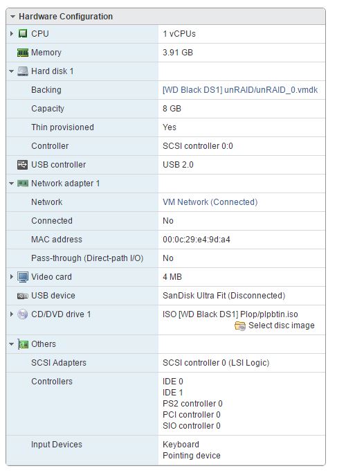

Esxi was able to see the 4 tb drive.
There is a SFF cable connected in every port in the back plane which then goes to the HBA card.So there is a total of 8 drive bars and 8 connectors. I just disconnected one of the SFF cables and connected a sata data cable from the drive bay that the 4 tb wd black drive is in and connected the other end to one of the onboard sata ports. I posted  pictures of the inside of server. The black sata data cable is the one that is connected to my 4 tb wd black drive.

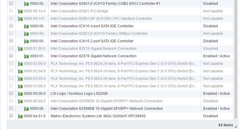

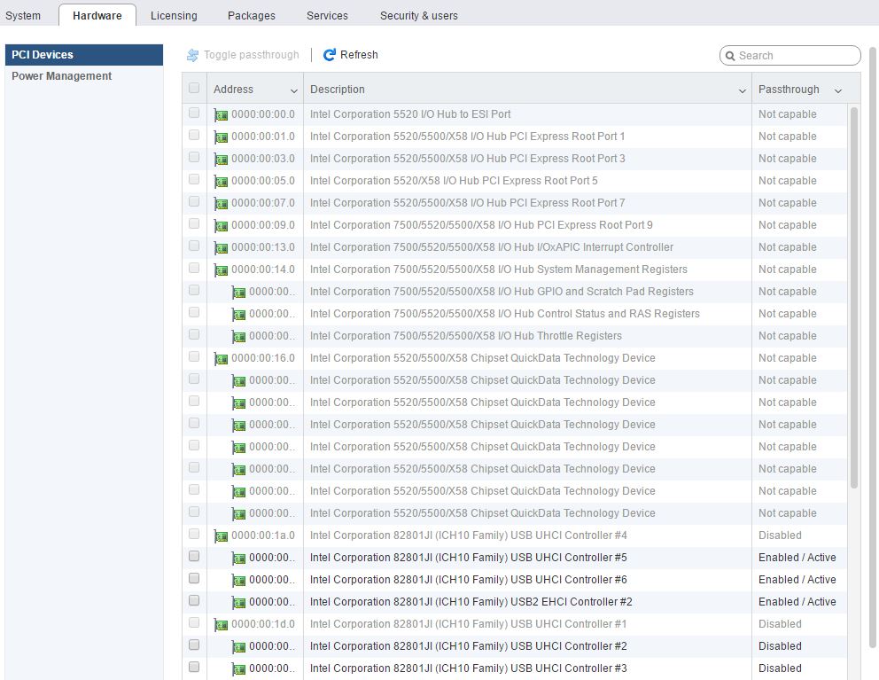

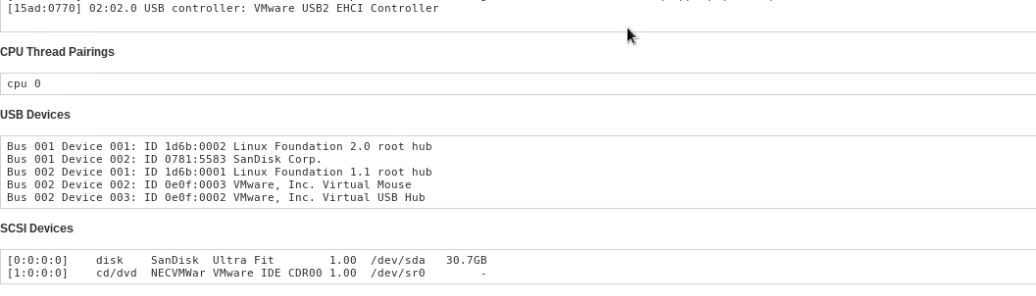

I was able to setup the passthrough
This whole process is  definitely an adventure.I was able to install Esxi 6.5  . I then followed the instructions that ATLAS had to download PLOP,WIN SCP and Putty. I was able to boot into unRAID and login to the previous setup.
However it doesn't detect any of my drives. I was looking at one article that the guy had a similar issue where it wasn't seeing the license file and he had to rebuild the unRAID usb stick with a clean version. I'm going to try that ,but I don't know if that would be why I'm having issues with unRAID not seeing the drives.

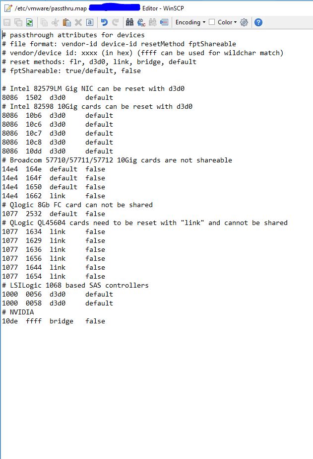

I didn't understand the part below . I was able to open my passthru.map file and added the false entry ,but I wasn't able to find the volumes folder where the vmx file was at. I posted my pass through file.
I also was able to toggle passthrough the  LSI HBA card  in vmware as well.
Applying the MV8 Hack
With "Remote Tech Support" enabled, use WinSCP to connect to ESXi, and add there two lines to the /etc/vmware/passthru.map file:
# Marvell Technologies, Inc. MV64460/64461/64462 System Controller, Revision B
11ab  6485  d3d0     false
Now open your VM's .vmx file and change this:
pciPassthru0.present = "TRUE"
pciPassthru0.deviceId = "6485"
pciPassthru0.vendorId = "11ab"
pciPassthru0.systemId = "4dfc27f9-93be-d5c1-9198-00259027d9d8"
pciPassthru0.id = "01:00.0"
to this:
pciPassthru0.msiEnabled = "FALSE"
The catch is force the use of IOAPIC mode with the "pciPassthru0.msiEnabled = 'FALSE'" statement.
Reboot the hypervisor and start your unRAID VM!
Good luck.
* Note, the pciPassthru0 # could be different depending the number of cards you have passed though. For my last rebuild, it was pciPassthru3
First, congrats you on able to build up your ESXi and setup unRAID VM! :)

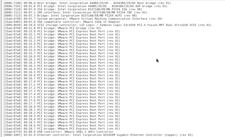

are you sure, you need this ? you wrote you have LSI 9211-8i card, but this hack is needed for supermicro cards..

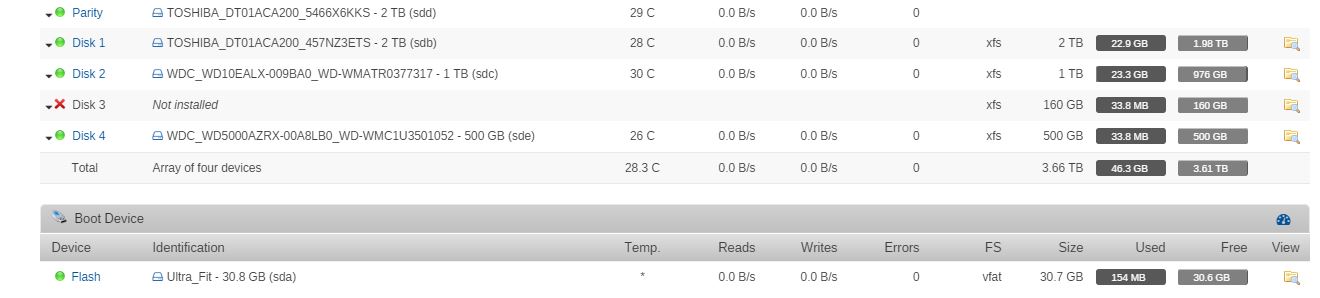

when you boot up your unRAID, are you able to see your drives in drive slots choose under Array Devices?
Thats a good question. That makes sense. I don't have the Marvell ,but I thought it was a generic option to put in.
I swear everytime something goes right ,something else goes wrong with this process. So I did a clean install on unRAID and now when I login to unRAID I can't use the mouse ,but I can use the tab key.
After doing the clean install it is now having me register the trail key. I will register it later and let you know if it shows the drives.

I have already performed a clean install on it,so at this point I have to register it.

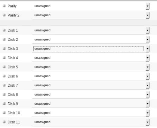

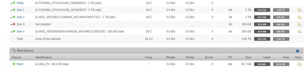

Before I did a clean install on the flash drive , I installed the drives for the array. The drives had a message that said they were missing. I then shut down the  VM, then restarted the vmware server and then logged back into vmware and then started the unRAID vm up again and they still weren't showing up.
I think this might have to do with the pass-through options possibly.  Also I can't move the mouse around to click on anything. It appears as though I can use the tab key and go up and down,but still no mouse.
I just found out that I'm not getting a network connection within unRAID.
I tried to copy and paste the register key ,but it gave me an error.
I then tried to go out to several websites such as google and yahoo ,but wasn't able to. I then restarted and then went to the command line unRAID OS.
I then get Tower Login: Device "eth0" does not exist.
When I run the ifconfig eth0 I get error fetching interface information:device not found.
I tried to edit the syslinux.cfg file ,but that didn't work.
Sorry for laying all of this information out on you. It seems like it is more work to try to get unraid to work through vm.Lol

Please, post a picture of unRAID VM Settings.
I attached the settings to my unRAID vm and also the pci pass through devices that come up .
I was reading other forums talking about how there AMD(Advanced Micro Devices) network card wouldn't work in vmware ,but they got it to work in virtualbox by changing the chip set to Intel .
I also see the speed difference between having a datastore on a hdd and sdd. The boot up of unraid is slow.
There is probably something that I didn't do right  , such as selecting the wrong pass-through device or not selecting the correct one. hopefully and maybe you'll be able to see it.
Well I have network connectivity now. I changed the network adapter in the vm to use the E1000  adapter type.
I still can't actually move the mouse around. I thought it might be a lagging issue ,but I have moved the mouse around to see if the mouse arrow moves ,but I waited about 10 to 15 minutes and it never moves. I can move around a little by using the tab key.
So now I tried to see if I could now assign the drives are plugged into the backplane ,but it doesn't show up with any of them. I think it could be that I may need to add the LSI PCI device. Not sure if that will allow the drives to be detected.
I post added screenshots of the system devices and also the pci device option I was
So I seem to keep digging deeper and playing around. As I do so I seem to be answering my own questions.Lol. :)
So now I got unRAID to see the array drives. I still don't know why the mouse emulation isn't working . That is very bothersome.
I'm going to see how it goes with assigning the drives and see if it will work out for me.At least the drives are showing up. I'll see how it goes from there.
Let me know about the mouse emulation ,if you see anything in any of the screenshots that I may need to change.
Congrats to you to get this up and running, a few more tips from me:
- use VMXNET3 as your network adapter, this enables 10Gbit networking inside ESXi between VMs
- use plopKExec to speed up boot times - https://www.plop.at/en/plopkexec/full.html
- are you booting GUI version of unRAID? i think no need of that. just boot non-gui version and then connect to your unRAID from LAN from another device by http://<your-unRAID-ip>/
- every ESXi VM, including unRAID needs VMWare tools installed inside it. for unRAID use this one: https://forums.lime-technology.com/topic/36603-open-vm-tools-for-unraid-6/
good luck, if you have more questions, just ask :)
and about your PCI devices - why you are passing so many devices? for unRAID you just need LSI 2008 to pass-trough. if you pass-trough a device, it's not visible to ESXi host, and then you need to add it to particular VM and then this device is used only for this VM. Virtual network from ESXi works just fine, so does USB attaching to VM too.
