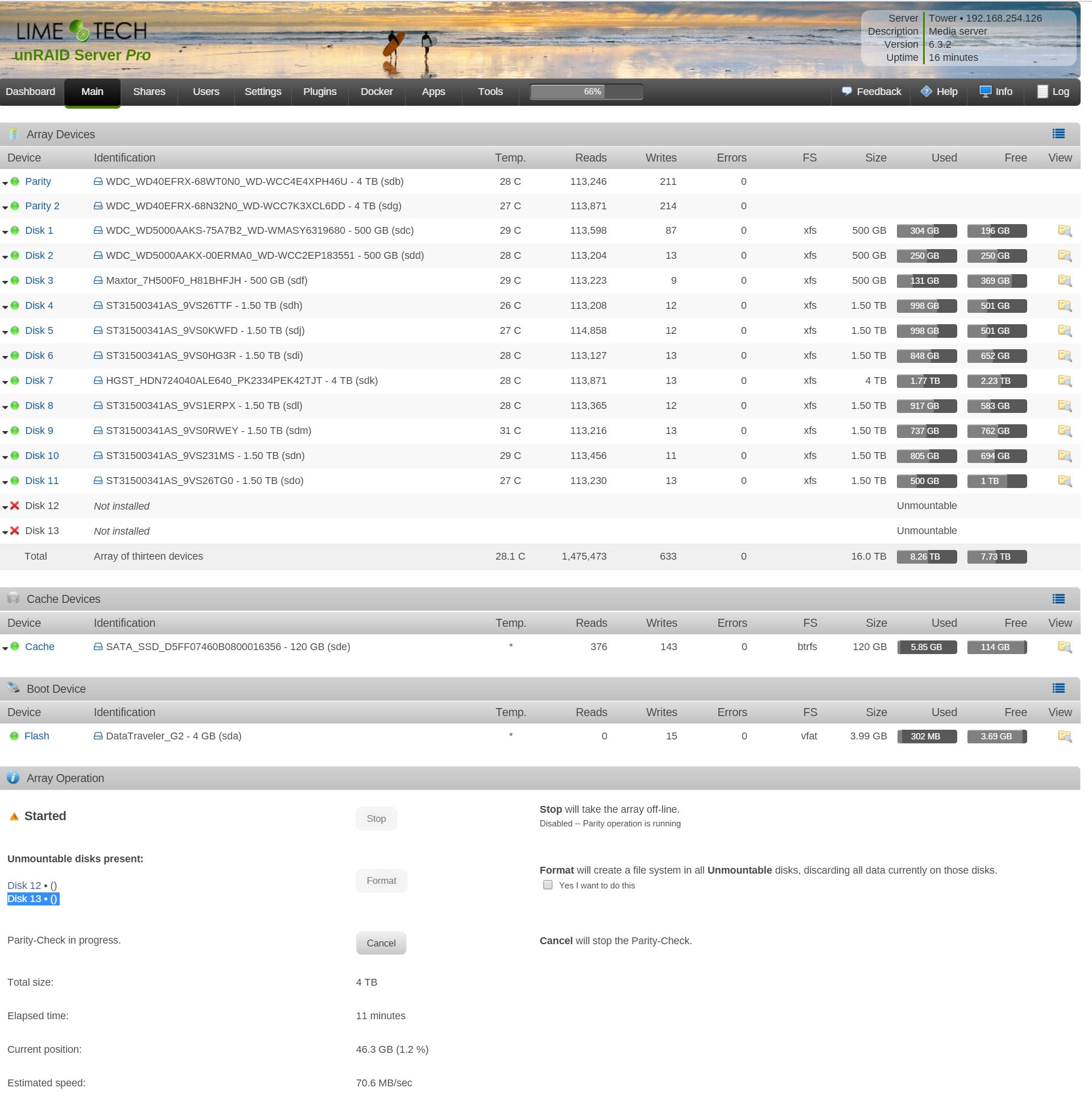

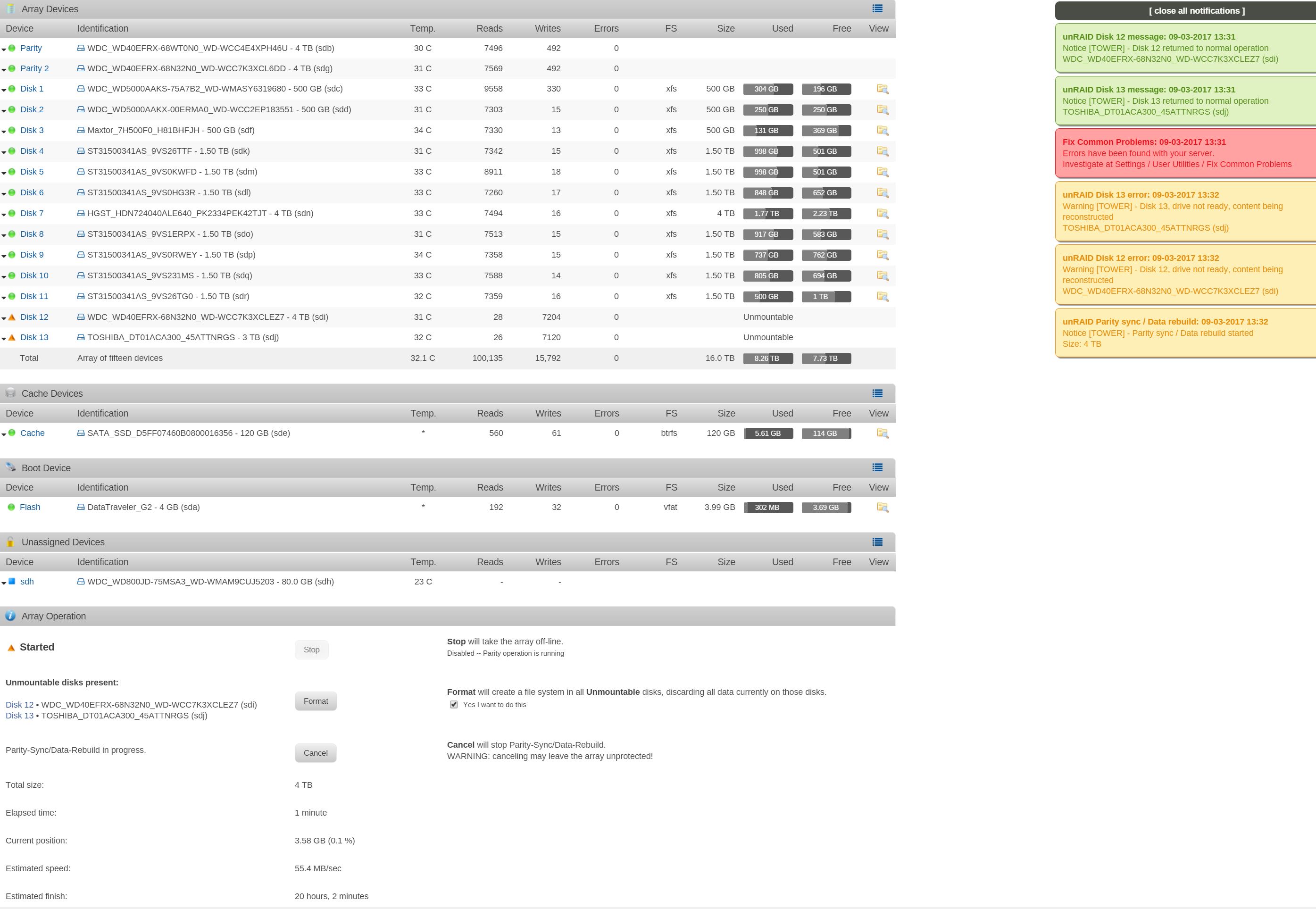

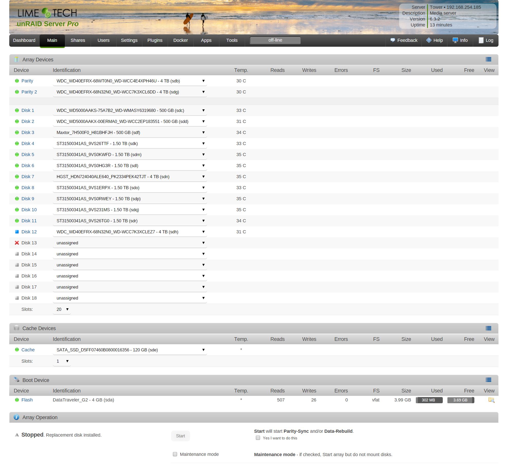

When I got into the unRAID it had red X's next to the 2 new drives.
I started the array and it immediately started Parity check. So I am not really sure what to do at this point.

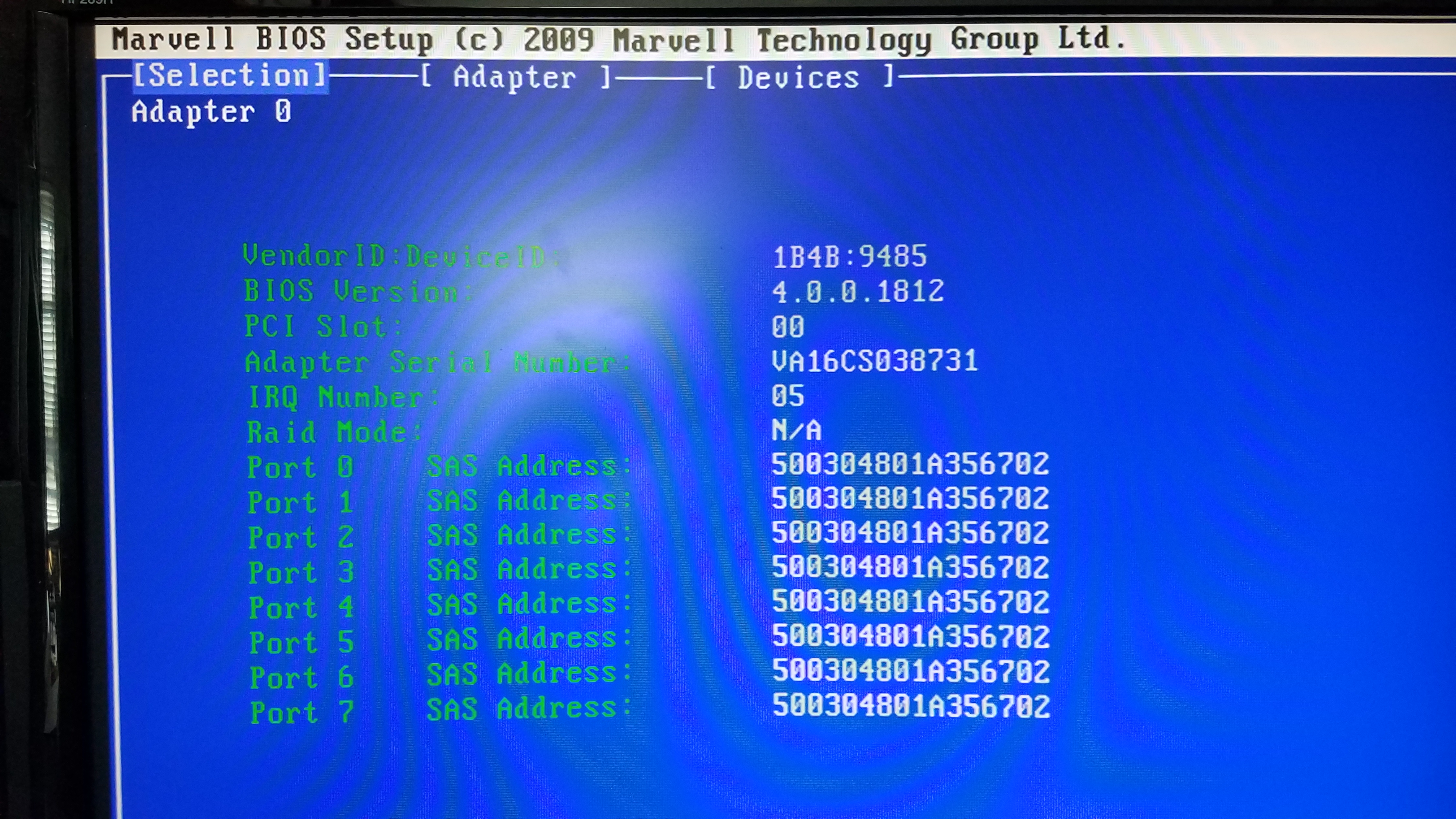

I haven't disabled Int13 like they are talking about at the end of the thread. I am however using the latest 1812 firmware for the new raid card.
Should I stop the Parity Check and reboot to disable the Int13?

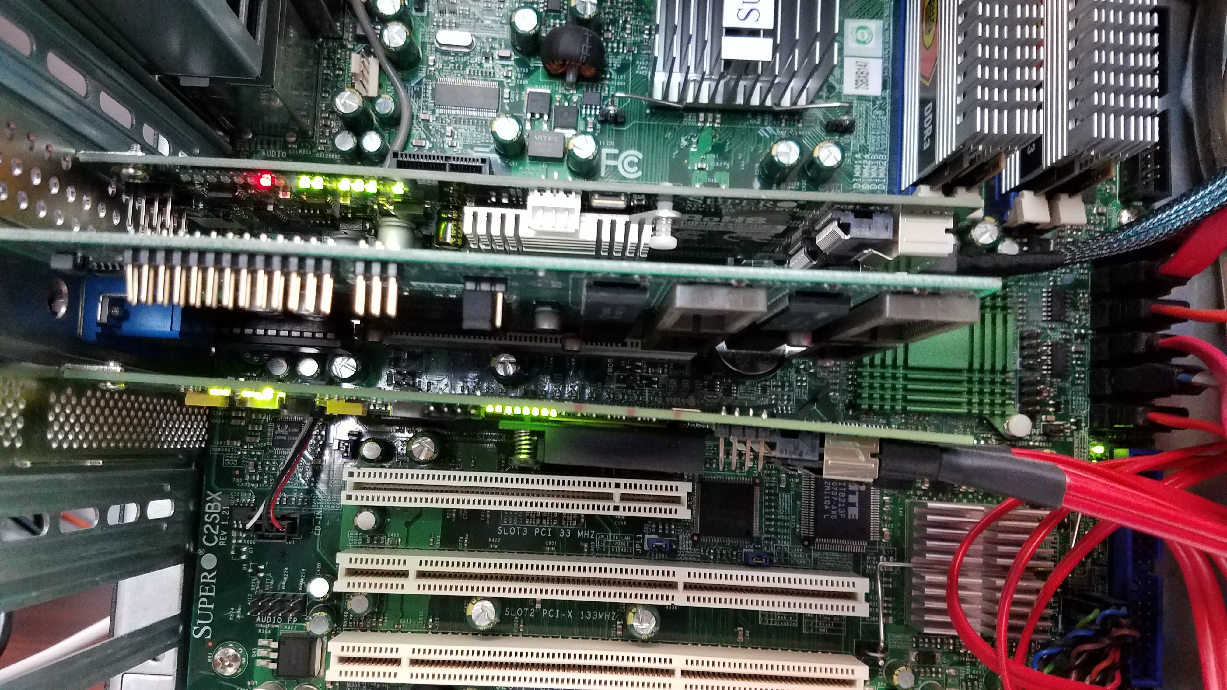

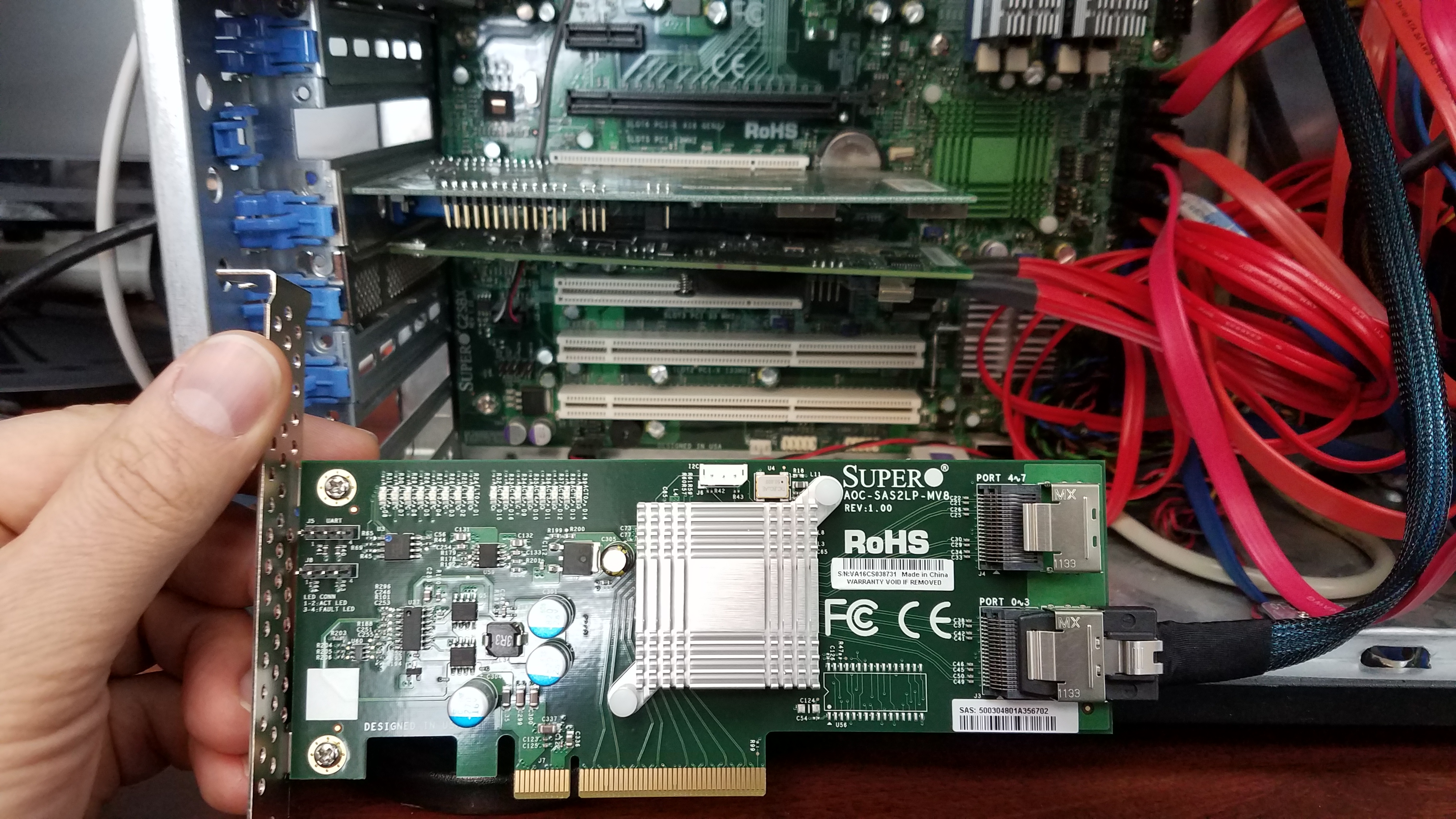

You don't have a SAS2LP, you are using a LSI2008 based controller, also all your the connected disks are assigned, you have 6 onboard + 8 on the LSI, 14 total, (2 parity + 11 data + cache), where were the other disks connected?
What you're seeing the onboard HDs, correct, then LSI card (on the bottom of the pic) with SAS2LP being the top card. The cables from it go directly into the HD enclosure.
On bootup the SAS2LP was working properly yesterday when I started adding them to the array.
The card is still showing up on bootup and it does detect the 2 drives that are attached to it.
UnRAID just quit seeing them :(

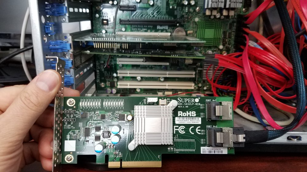

On the SAS2LP card D2 led is the one lit solid Red. Not sure what is the meaning of it since I have no manual or cant find one online.
No SAS2LP being detected by Linux, take out and install it again:

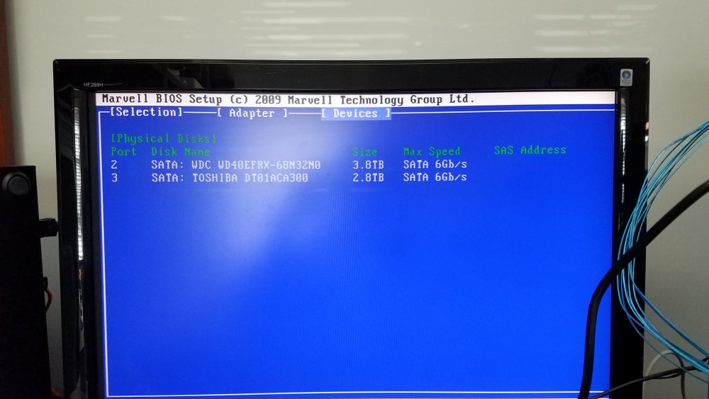

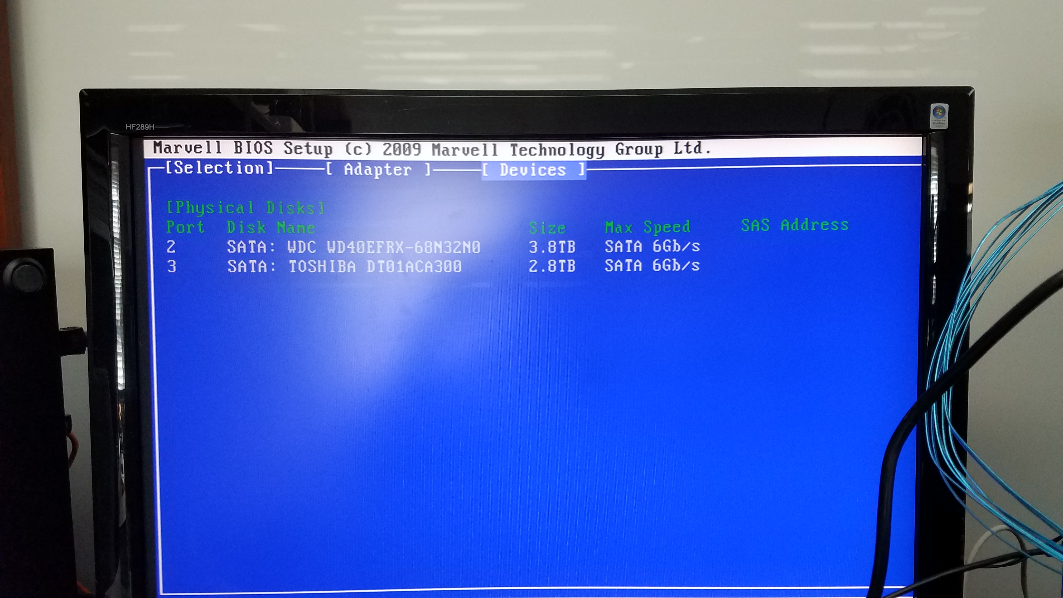

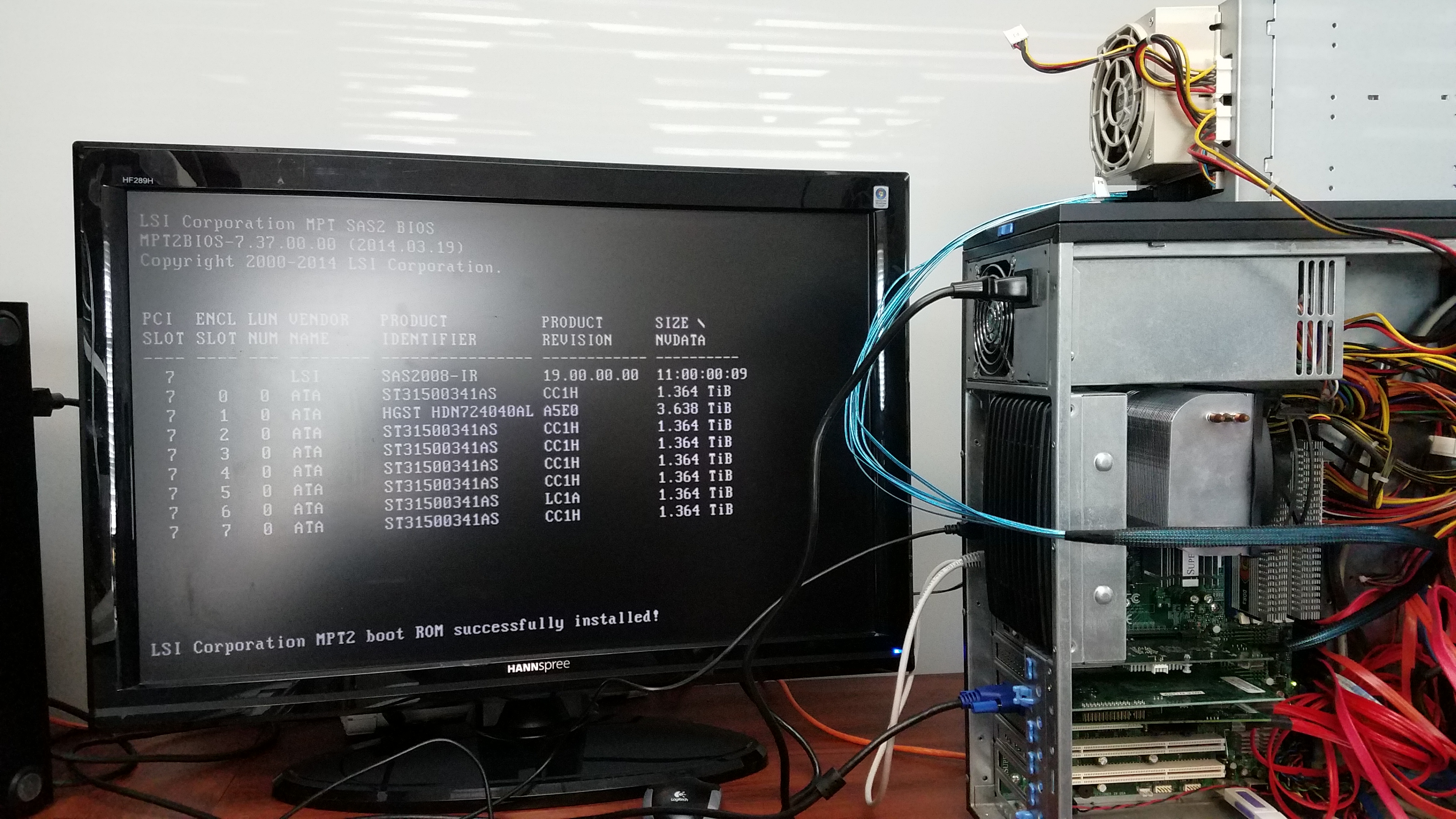

I reseated the card. Got into the BIOS and disabled the int13. As you can see in the BIOS it's picking up the 2 "missing" drives. (4TH and 3TB)
tower-diagnostics-20170309-1012.zip

Almost certainly the problem was caused by the controller stopping to be detected.

Disks were disabled, so they'll need to be rebuilt.
