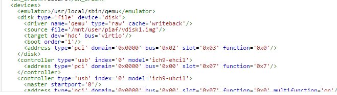

I converted the VMDK to IMG, created a new CentOS VM, attached the disk1.img file i converted.  VM does not boot.  Ive changed various settings in the XML and get different errors each time.  I think thats where my issue is, maybe not.  Either way Im at a dead end. This is all new, ive been using UNRAID for about 3 days now.  Love it, cant wait to get everything moved over. Crashplan, Owncloud, Plex are all working so far.

this might not help but try changing target dev= to had, and bus to sata.
also, post your full xml for the vm.

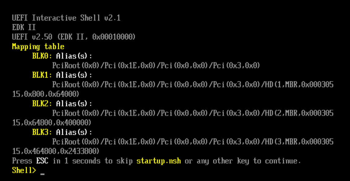

Now Im getting "Boot Failed. EFI Device".
I converted the image again to make sure i did it right. Attached to VM, created, loaded VNC and got that message. At least its something new.
<domain type='kvm'>
  <name>CentOS</name>
  <uuid>3cb57863-c633-3c8d-cf7d-c45d24038301</uuid>
  <metadata>
    <vmtemplate xmlns="unraid" name="CentOS" icon="centos.png" os="centos"/>
  </metadata>
  <memory unit='KiB'>524288</memory>
  <currentMemory unit='KiB'>524288</currentMemory>
  <memoryBacking>
    <nosharepages/>
  </memoryBacking>
  <vcpu placement='static'>1</vcpu>
  <cputune>
    <vcpupin vcpu='0' cpuset='0'/>
  </cputune>
  <os>
    <type arch='x86_64' machine='pc-q35-2.7'>hvm</type>
    <nvram>/etc/libvirt/qemu/nvram/3cb57863-c633-3c8d-cf7d-c45d24038301_VARS-pure-efi.fd</nvram>
  </os>
  <features>
    <acpi/>
    <apic/>
  </features>
  <cpu mode='host-passthrough'>
    <topology sockets='1' cores='1' threads='1'/>
  </cpu>
  <clock offset='utc'>
    <timer name='rtc' tickpolicy='catchup'/>
    <timer name='pit' tickpolicy='delay'/>
  </clock>
  <on_crash>restart</on_crash>
  <devices>
      <source file='/mnt/user/piaf/vdisk1.img'/>
      <boot order='1'/>
      <address type='pci' domain='0x0000' bus='0x02' slot='0x03' function='0x0'/>
    </disk>
    </controller>
      <master startport='0'/>
    </controller>
      <master startport='2'/>
    </controller>
      <master startport='4'/>
    </controller>
      <address type='pci' domain='0x0000' bus='0x00' slot='0x1f' function='0x2'/>
    </controller>
    <controller type='pci' index='0' model='pcie-root'/>
    <controller type='pci' index='1' model='dmi-to-pci-bridge'>
      <model name='i82801b11-bridge'/>
      <address type='pci' domain='0x0000' bus='0x00' slot='0x1e' function='0x0'/>
    </controller>
    <controller type='pci' index='2' model='pci-bridge'>
      <model name='pci-bridge'/>
      <target chassisNr='2'/>
      <address type='pci' domain='0x0000' bus='0x01' slot='0x00' function='0x0'/>
    </controller>
      <address type='pci' domain='0x0000' bus='0x02' slot='0x02' function='0x0'/>
    </controller>
    <interface type='bridge'>
      <mac address='52:54:00:80:0f:73'/>
      <source bridge='br0'/>
      <model type='virtio'/>
      <address type='pci' domain='0x0000' bus='0x02' slot='0x01' function='0x0'/>
    </interface>
    <serial type='pty'>
      <target port='0'/>
    </serial>
    <console type='pty'>
    </console>
    <channel type='unix'>
    </channel>
    </input>
    <graphics type='vnc' port='-1' autoport='yes' websocket='-1' listen='0.0.0.0' keymap='en-us'>
    </graphics>
    <video>
      <address type='pci' domain='0x0000' bus='0x00' slot='0x01' function='0x0'/>
    </video>
    <memballoon model='virtio'>
      <address type='pci' domain='0x0000' bus='0x02' slot='0x04' function='0x0'/>
    </memballoon>
  </devices>
</domain>

Ok, now I am getting the same error page (first picture up top) while trying to install a Scientific Linux VM with IncrediblePBX 13.2iso.
IT flashes for a split second Boot Failed....and I cant read the rest before it jumps to the screen with yellow.
Its booting!  Lemme see what I changed so I can post back.
I changed the advanced settings to SeaBios and drive type to sata and it booted my image right up. Now it cant find eth0 device. So im off to fix that.  Thanks for the help.
