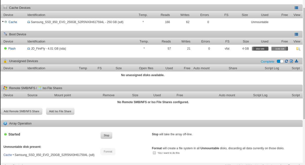

Been having some issues with my Unraid box since my upgrade to 6.3.2.  Noticed on my monitor connected to the box that I was seeing a series of "BTRFS csum failed" errors, which through reading suggested that it might be a problem with my docker container.
So.....just rebooted the server, was prepared to delete the docker file and reconfigure, and now my Cache drive is showing as unmountable.
Nothing has changed on the box from a HW perspective, and the only major SW change on it was the addition of a Plex Docker.
I've attached my diagnostics file...anything jump out as bad?
I'd really, really prefer to not have to revert to a backup and rebuild, but prepared to do so if necessary.
Thanks!
Ryan

You are having hardware issue with your SSD:
Mar 12 12:18:07 Tower kernel: ata14: limiting SATA link speed to 3.0 Gbps
Mar 12 12:18:07 Tower kernel: ata14: hard resetting link
Mar 12 12:18:12 Tower kernel: ata14: softreset failed (device not ready)
Mar 12 12:18:12 Tower kernel: ata14: reset failed, giving up
Mar 12 12:18:12 Tower kernel: ata14.00: disabled
Power down, check/replace cables and try again.
SSD is still being disabled, if you already replaced cables try a different controller, if it continues to happen you may have a bad device.
Mar 12 12:47:12 Tower kernel: ata14.00: disabled
