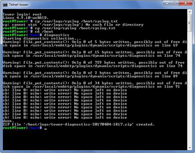

Still no luck, no GUI, and the diagnotics file is blank. Here is the syslog, perhaps you can spot something not quite right. Also attached is a screen shot when diagnotics was run.

Probably an issue with flash. Since you are basically starting from scratch anyway, you might start over by preparing flash from scratch also. Be sure to copy your key file.
Looks like a problem with the flash drive, it can't write to it.
