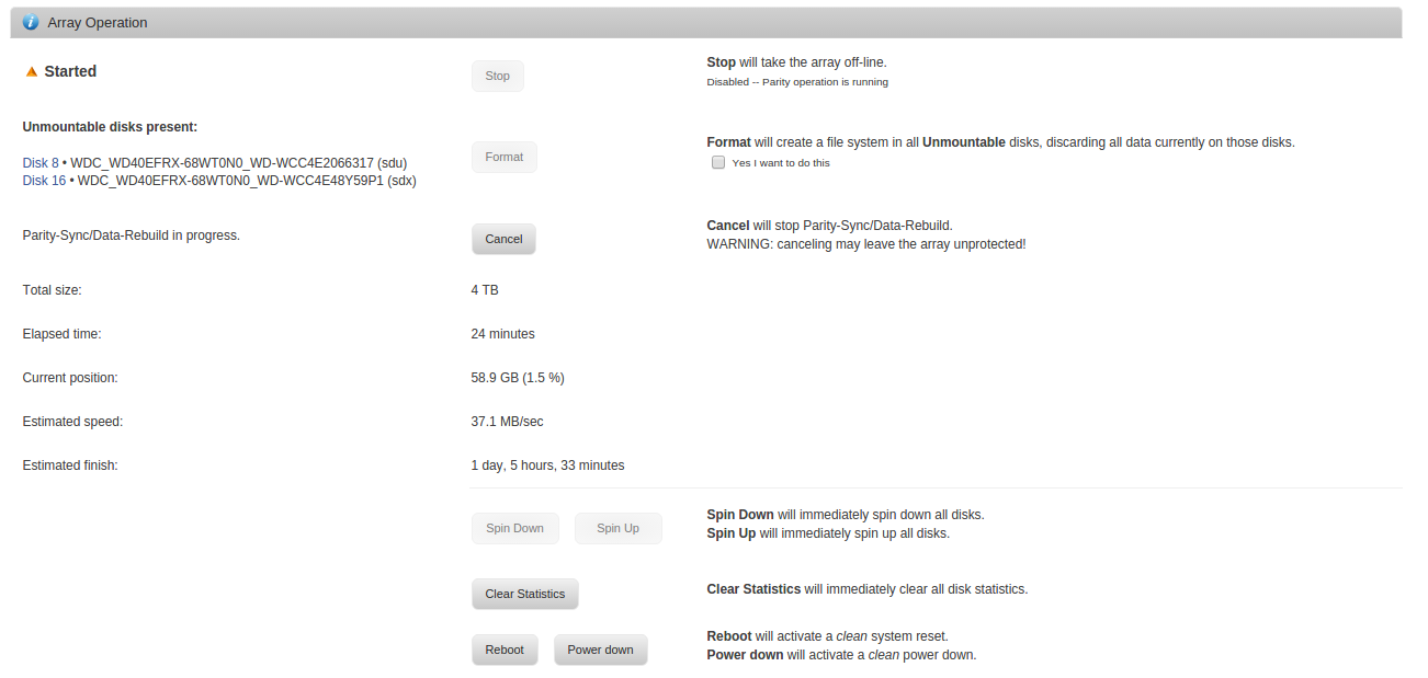

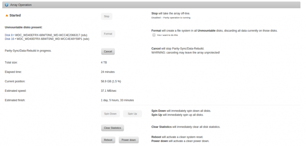

Diagnostics attached... also the "unmountable" message...

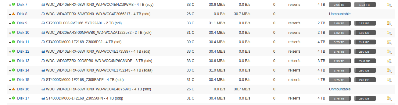

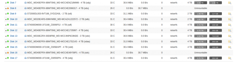

One more pic of the data-rebuild etc...
Let the rebuild finish, then run reiserfsck.
Also keep old disks intact in the meantime.
