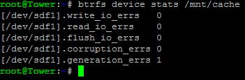

I have had a similar issue. Upgraded to 6.3.3 and now Docker will not start.
tower-diagnostics-20170414-1843.zip
I have deleted the docker image several times and re-created. I have also increased the size. Still I have failed to get the docker to start.
Any ideas would be appreciated.
Thanks.
When did you delete it? Syslog shows docker image corrupt from array start, it stayed like that for several hours and it was never re-created.
Delete, re-create and post new diags if errors persist.
Attached diagnostics again.
Image deleted. Docker still fails to start and fails to create a new image.
Seems by cache drive is read-only.
Not sure how that's happened.
tower-diagnostics-20170414-1912.zip
Yes, cache went read-only, best to copy everything important, stop docker and format cache, after that start docker again to recreate image.
