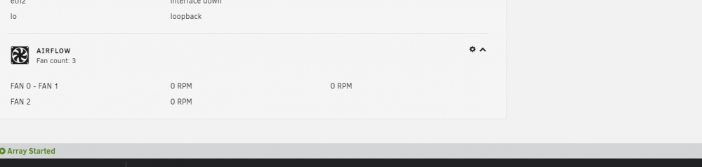

I was been using the Auto Fan Control plugin for the latest months and it was working like charm.
Suddenly and after upgrading to v6.3.3 it stopped working. It doesn't detect sensors any more.
Few months ago it was installed along with Nerd Tools pack perl version and detected relevant sensors with success.
I also upgraded to the latest perl version but again nothing. (Mobo: ASRock - 970 Pro3 R2.0)
Any ideas?
Thanks in advance.

Actually I cannot find anything unusual in logging. However after executing sensors command I only get the following output:
root@Tower:~# sensors
fam15h_power-pci-00c4
Adapter: PCI adapter
power1:       42.30 W  (crit =  45.05 W)
k10temp-pci-00c3
temp1:        +33.8°C  (high = +70.0°C)
                       (crit = +70.0°C, hyst = +67.0°C)
root@Tower:~#

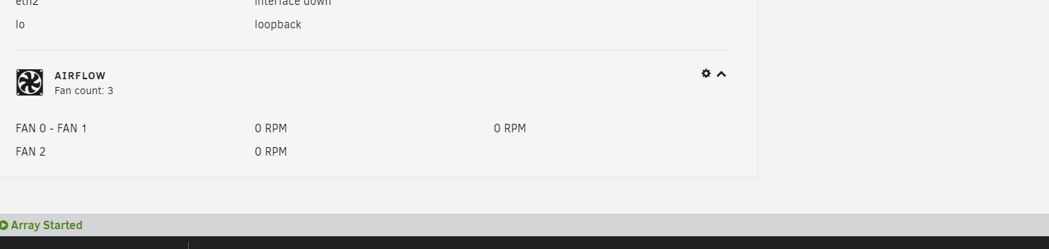

  • 2 years later...
Is anyone having the issue of when uninstalling the plug in it doesn't get rid of the tile on the dashboard?
