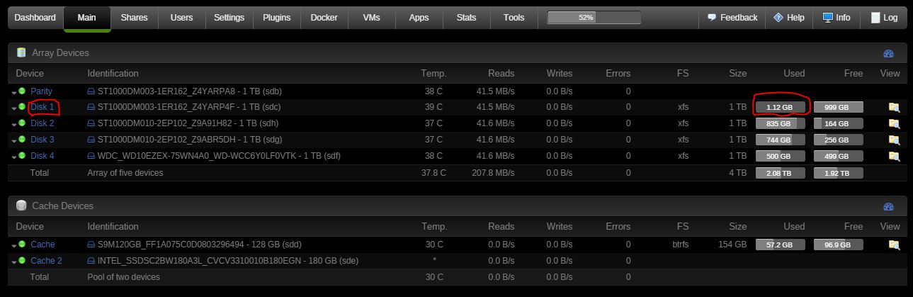

But all the data on DISK1 seems to be lost!!!! I can barely hold back the man tears. There used to be 500-600 GB on this disk which is lost. I have attached a picture of the same. IS THERE ANY WAY TO GET IT BACK ???

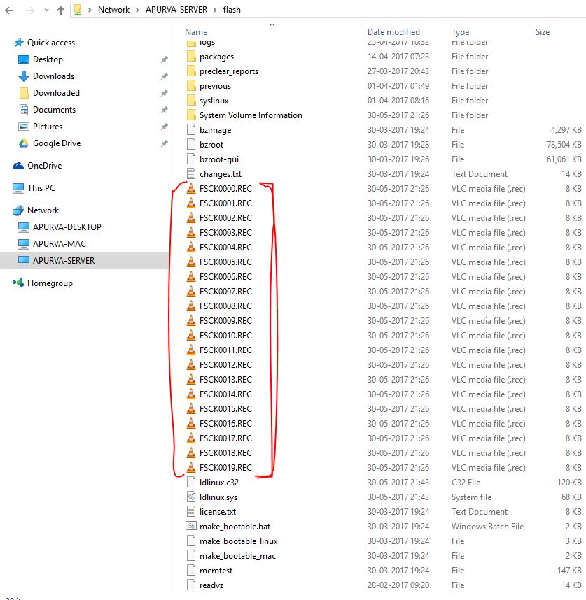

There is a list of .rec files in the UNRAID flash root (attached pic), can they be helpful in recovery?
No, these are lost fragments from the checkdisking the flash drive.

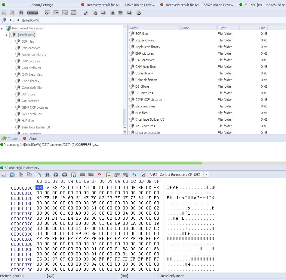

Using UFS Explorer, the scan on the disk returned results in a tree view, arranged by filetypes.
I am exporting the entire 'InteliRAW' tree to an external NTFS HDD. I will then use an Ubuntu virtual machine to copy files from the NTFS HDD to the original Segate internal HDD formatted in XFS.
Does this make sense?
One minor problem with this recovery is that I have lost the directory structure, and will have to recreate the structure and manually place these files there?
