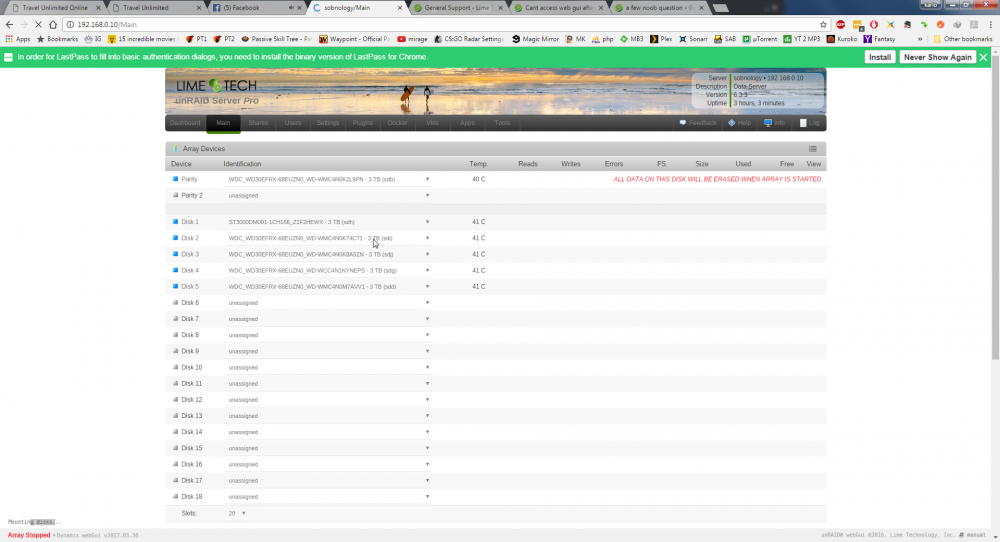

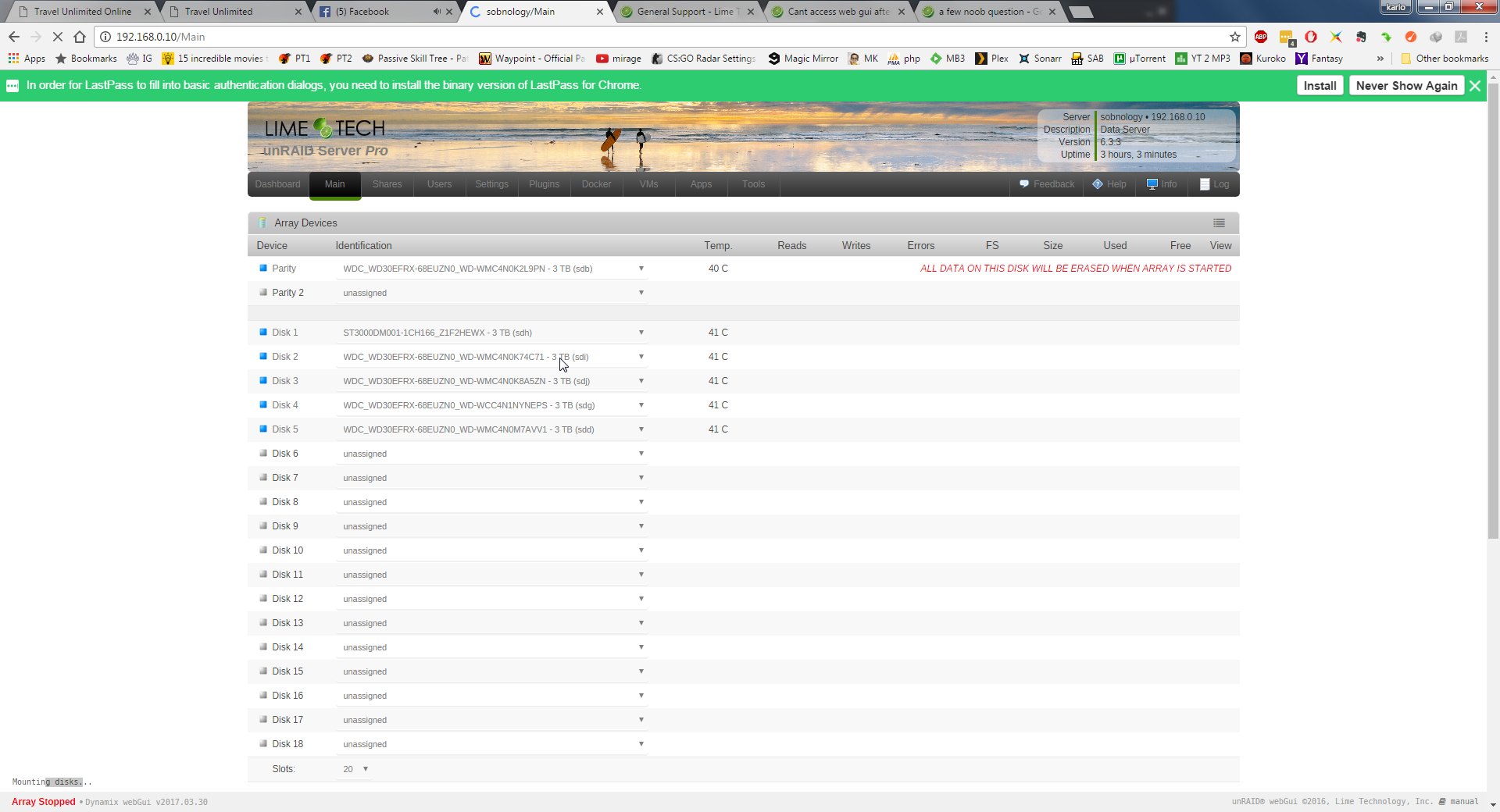

Best now would be to do a new config and resync parity:
-tools -> new config -> on "retain current configuration" select "all" then click apply
Start array to begin parity sync.
You'll still need to run xfs_repair on disk4, before or after the parity sync.
I already started the array. Cant access anything on the web gui, it just says mounting disks with a loading icon on the browser tab. Is this normal?
It's probably the file system issue on disk4, or on another disk, you should still be able to grab the diags in the console by typing diagnostics, upload those, if you can't, then reboot, start in maintenance mode and run xfs_repair on all disks.
im on this page for 3 hours. is this normal?
should i force reboot?
Get the diagnostics on the console, it should still work, and then, either way you'll need to reboot, first try on the console:
powerdown -r
If it doesn't reboot after a couple of minutes you need to press reset.
Those diags don't help, it would only help the ones from the console after starting the array, do that or start in maintenance mode and run xfs_repair on all disks.
went to maintenance mode and then resync.. 5h 30m to finish. Hope this will be successful.
