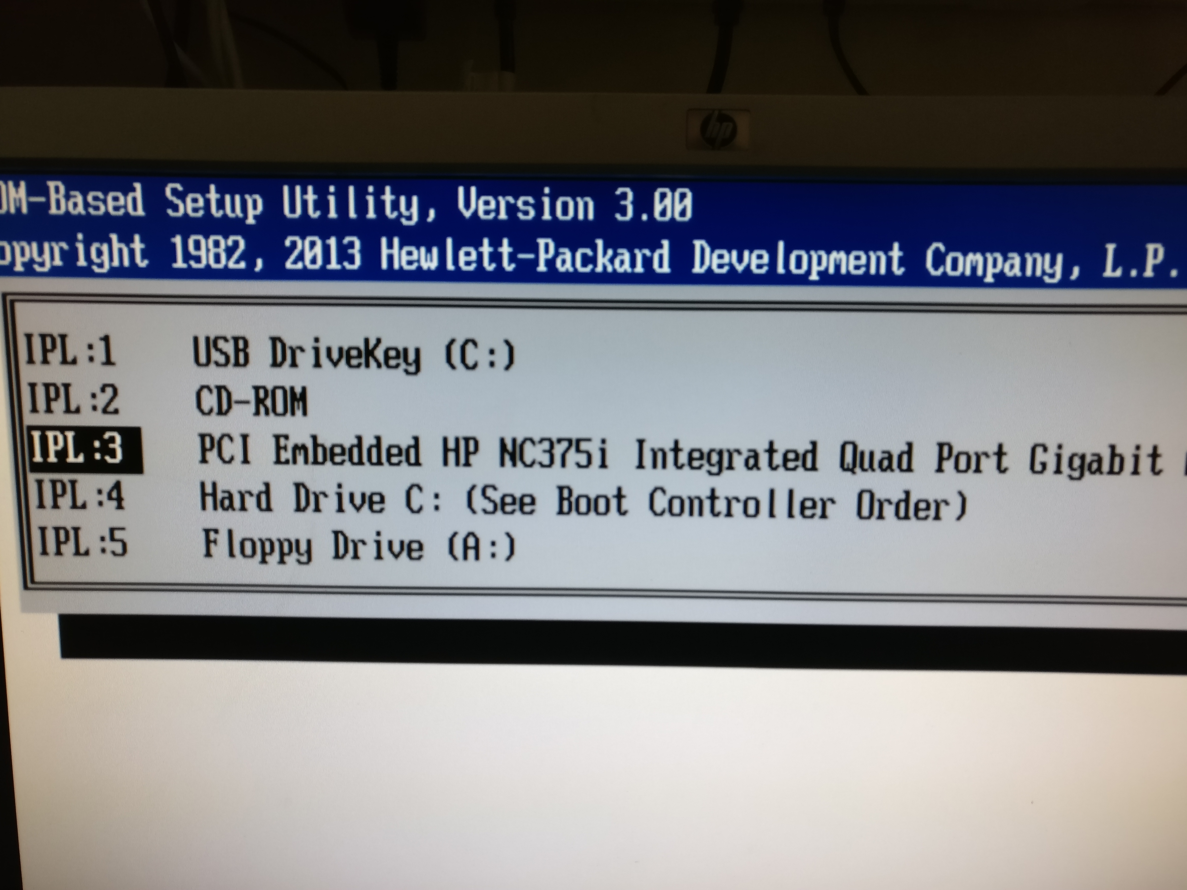

The network card is a:
HP NC3751 Integrated Quad Port Gigabit which can also be seen as a NetXen Incorporated NX3031

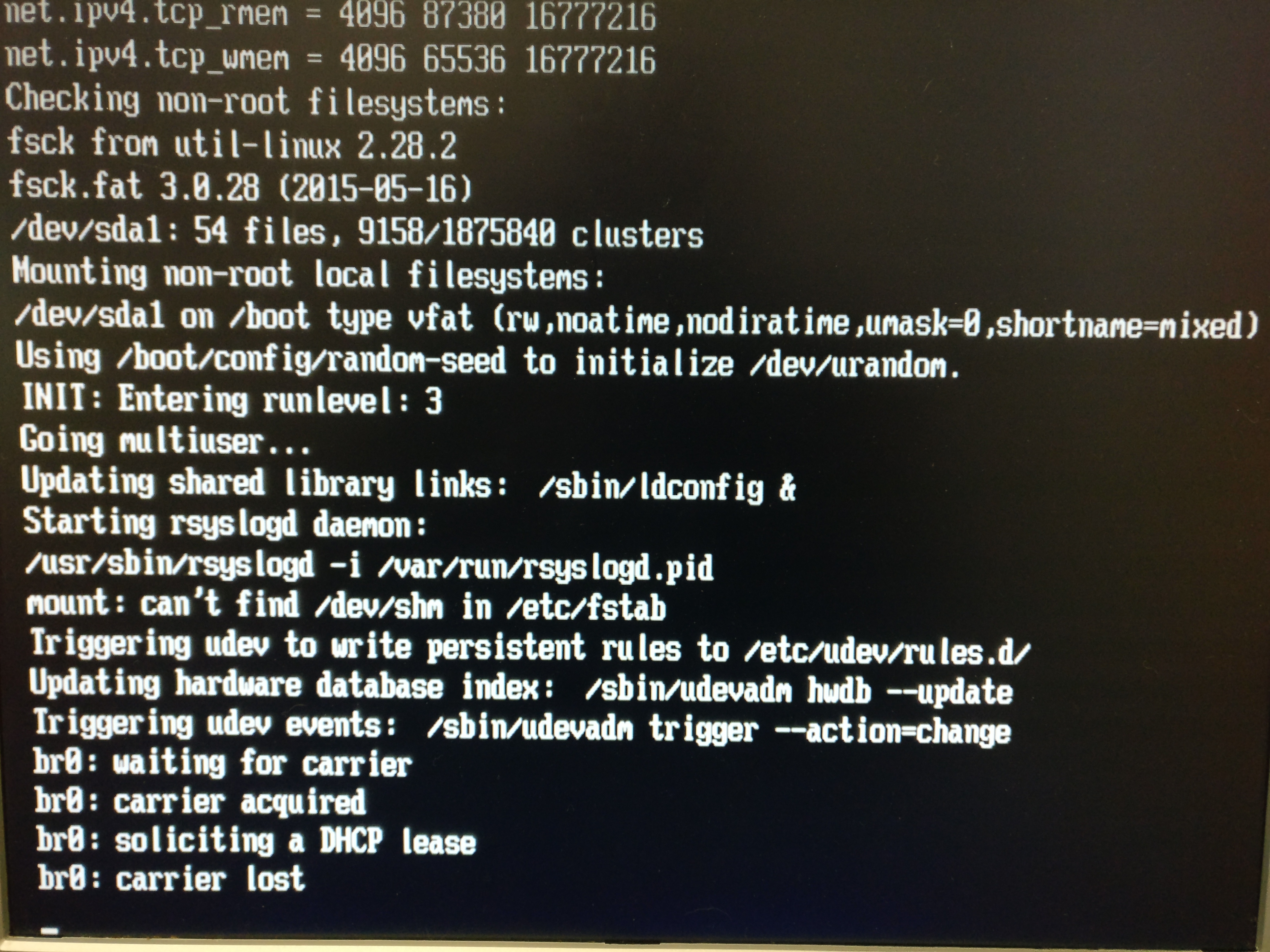

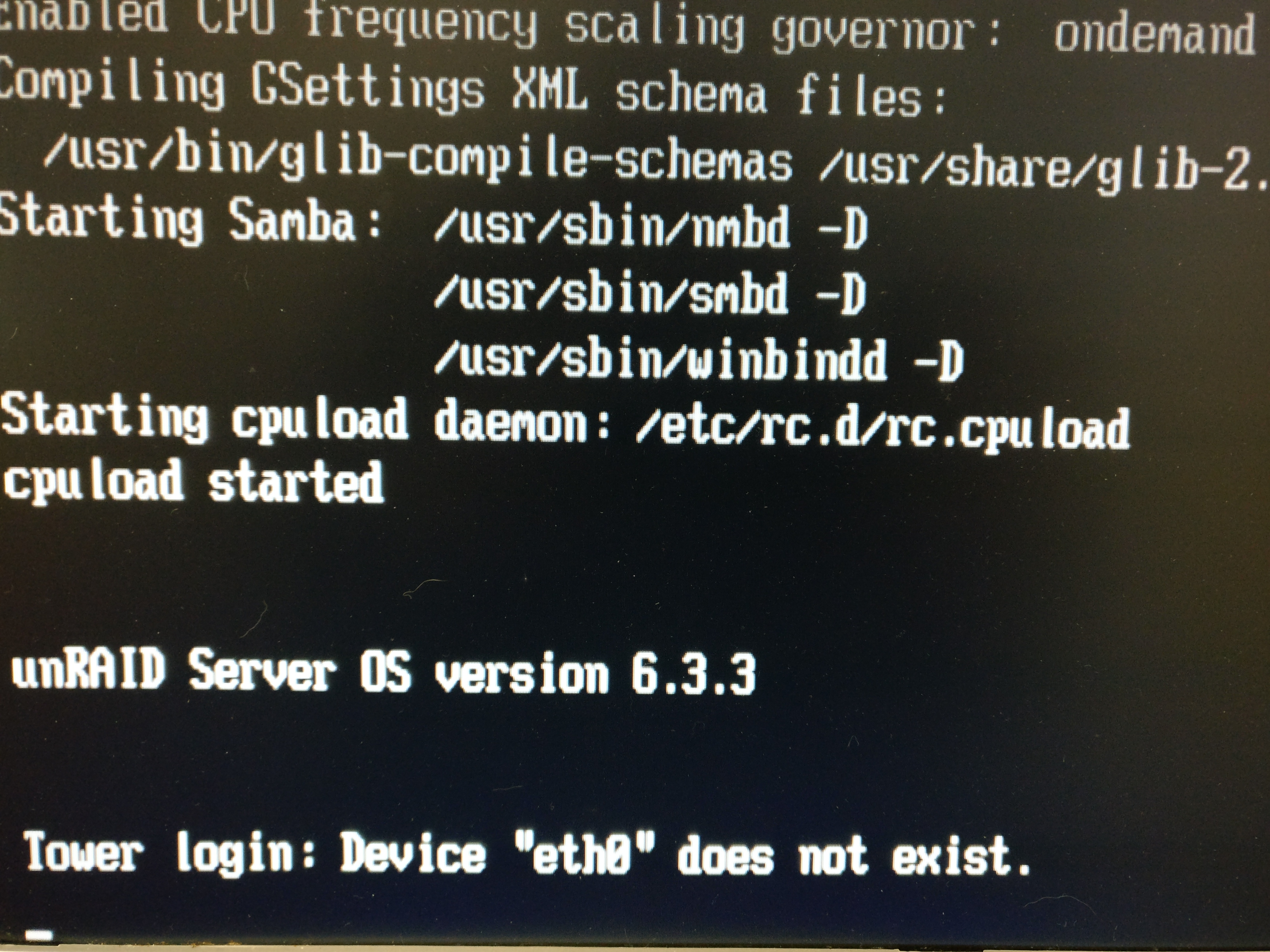

On load UNRAID reports:
br0: waiting for carrier
br0: carrier acquired
br0: soliciting DHCP lease
br0: carrier lost
and the console states:
Device "eth0" does not exit.

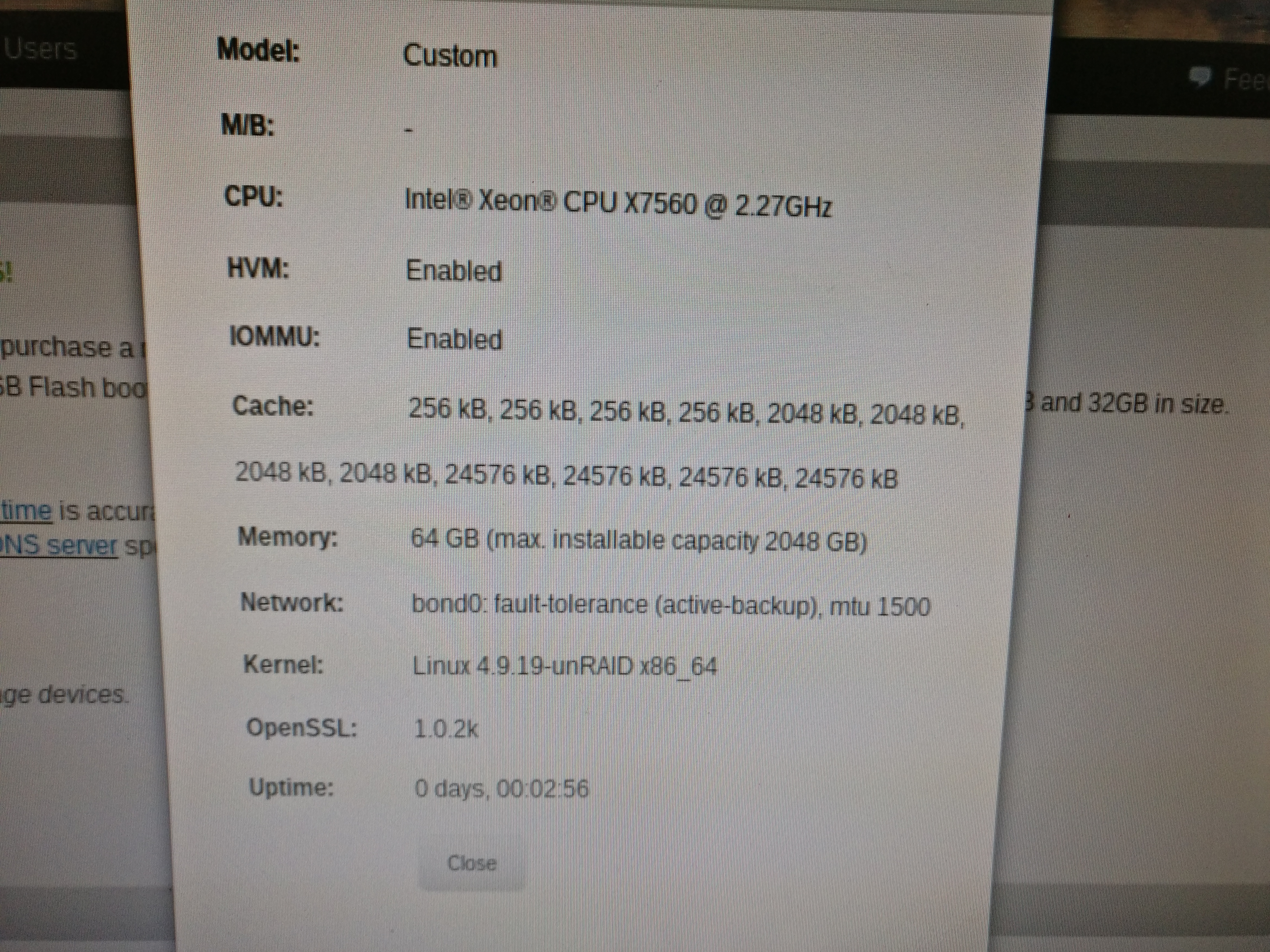

With the info (from the top right of the screen) says:

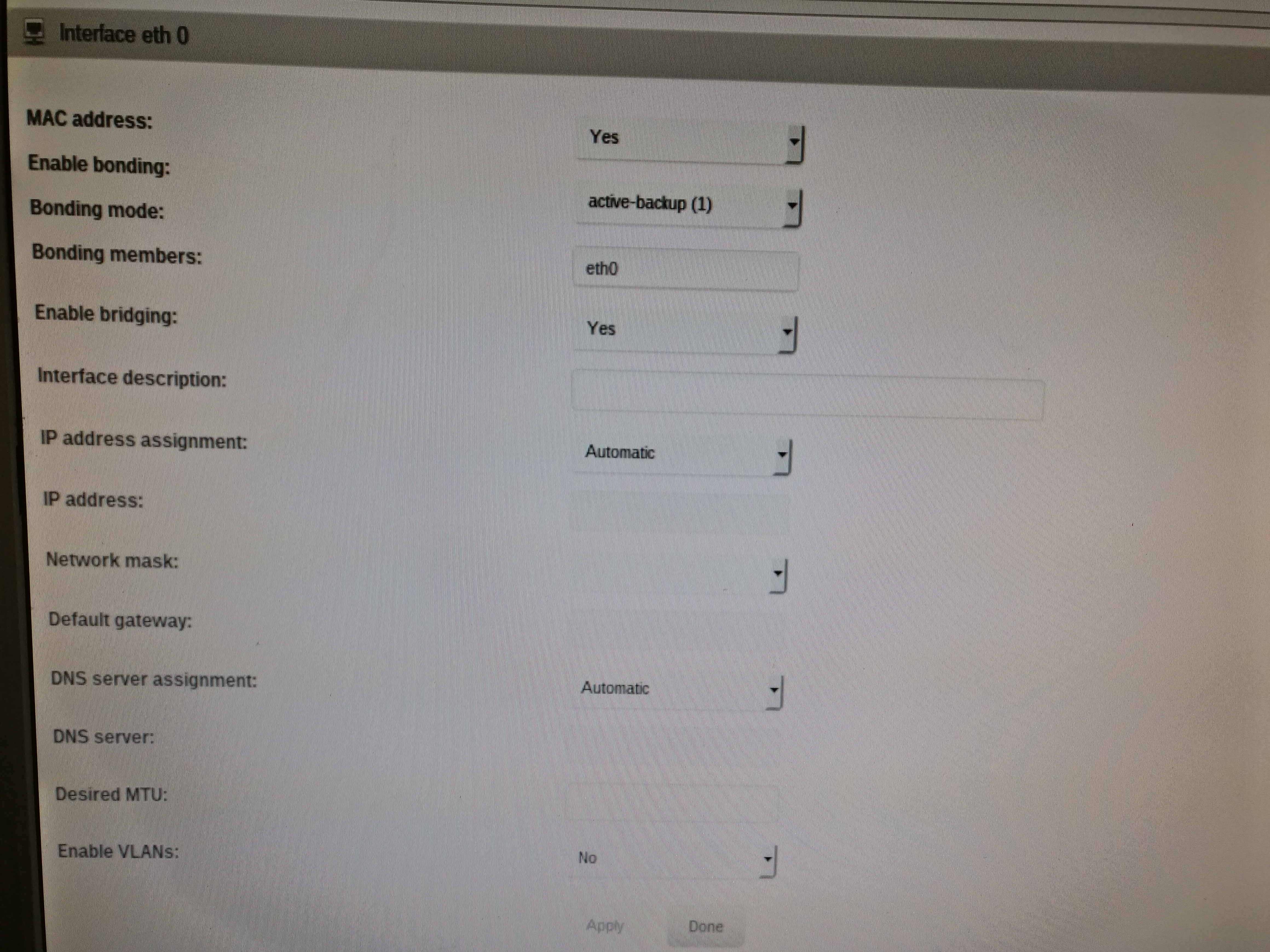

Network: bond0: fault-tolerance (active-backup), MTU 1500
All 4 ports are connected to the switch with no bonding set-up on the switch at  this time.
I'm kind of stuck here, so any help would be appreciated. Thanks.

try adding all 4 ports to the bonding group and leave it as active-backup. maybe just eth0 is wonky/not working right.

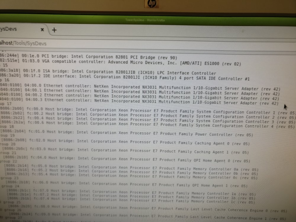

I've stall has no luck with this, but it looks like UNRAID is thinking that it's a 10Gb card but it's a quad 1Gb and loading the wrong drivers. The post that 1812 linked to mentions that an expansion can be added to the card making it 10Gb, so that might be the issue and why it's not working.
Ethernet controller: NetXen Incorporated NX3031 Multifunction 1/10-Gigabit Server Adapter
I've tried the setting LAG on all the relevant ports as 1812 recommended, but still no IP. It's the same when only one port is in use and LAG is disabled.

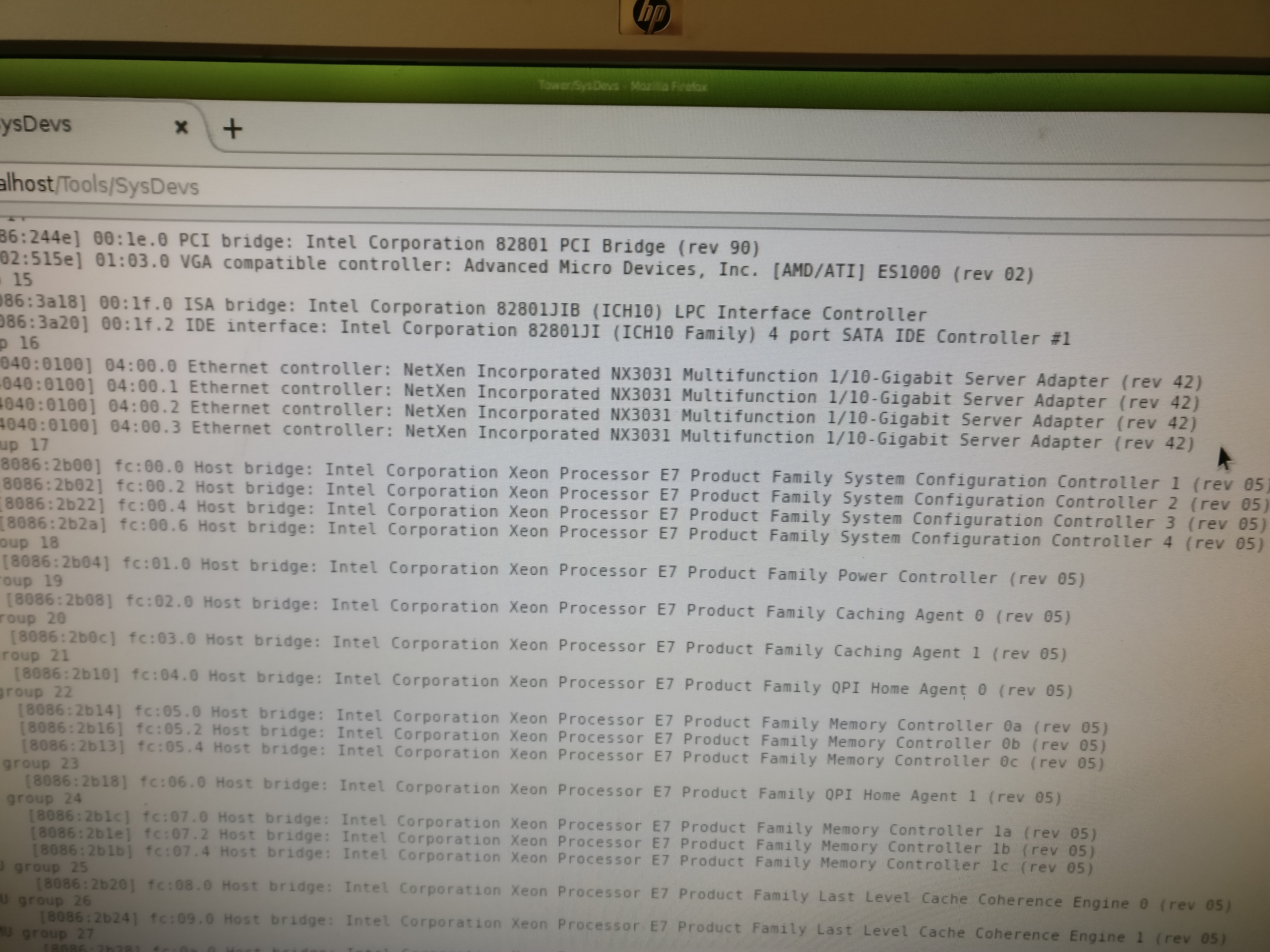

04:00.0 Ethernet controller [0200]: NetXen Incorporated NX3031 Multifunction 1/10-Gigabit Server Adapter [4040:0100] (rev 42)
    Subsystem: Hewlett-Packard Company NC375i Integrated Quad Port Multifunction Gigabit Server Adapter [103c:705a]
04:00.1 Ethernet controller [0200]: NetXen Incorporated NX3031 Multifunction 1/10-Gigabit Server Adapter [4040:0100] (rev 42)
04:00.2 Ethernet controller [0200]: NetXen Incorporated NX3031 Multifunction 1/10-Gigabit Server Adapter [4040:0100] (rev 42)
04:00.3 Ethernet controller [0200]: NetXen Incorporated NX3031 Multifunction 1/10-Gigabit Server Adapter [4040:0100] (rev 42)
There's no driver loaded for that NIC, it won't work on current unRAID, your best bet is to send an email to LT and ask to add that driver, they usually add it in the next release.
Thanks for the information. I'll do that.
I'd assumed (incorrectly) that since UNRAID identified the card, and it had loaded a driver, not necessarily the correct driver though. That it was something that I was missing. Kind of like how Windows would just say unknown device or it just wouldn't show.
Out of curiosity, how did you know that there is no driver? Is there are list of drivers included in releases somewhere? Just trying to build my UNRAID knowledge...
