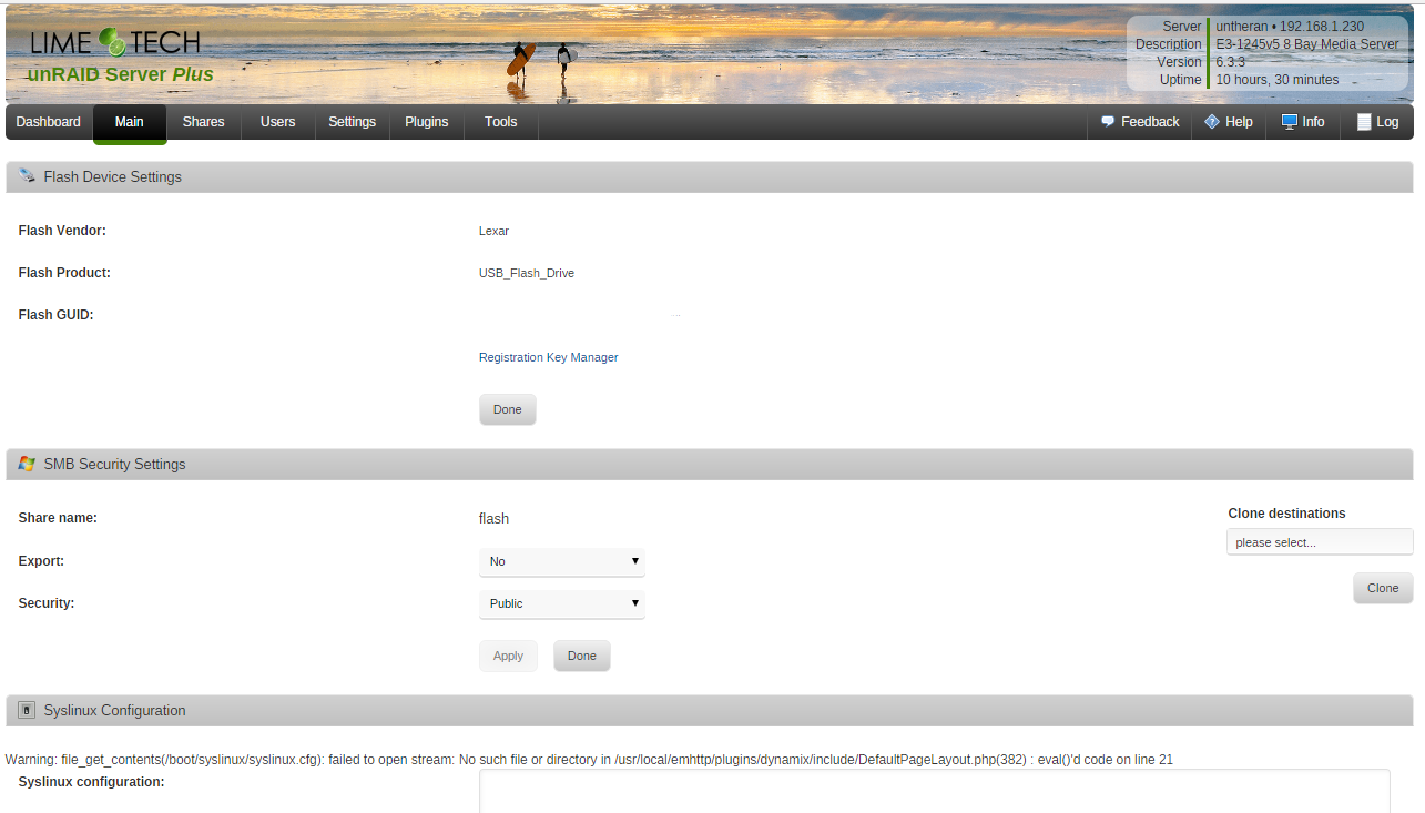

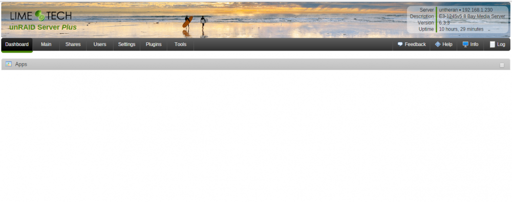

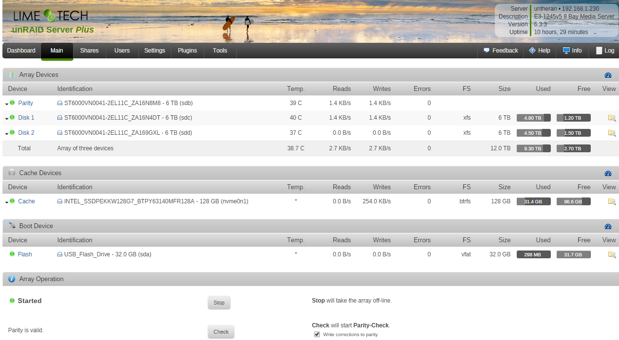

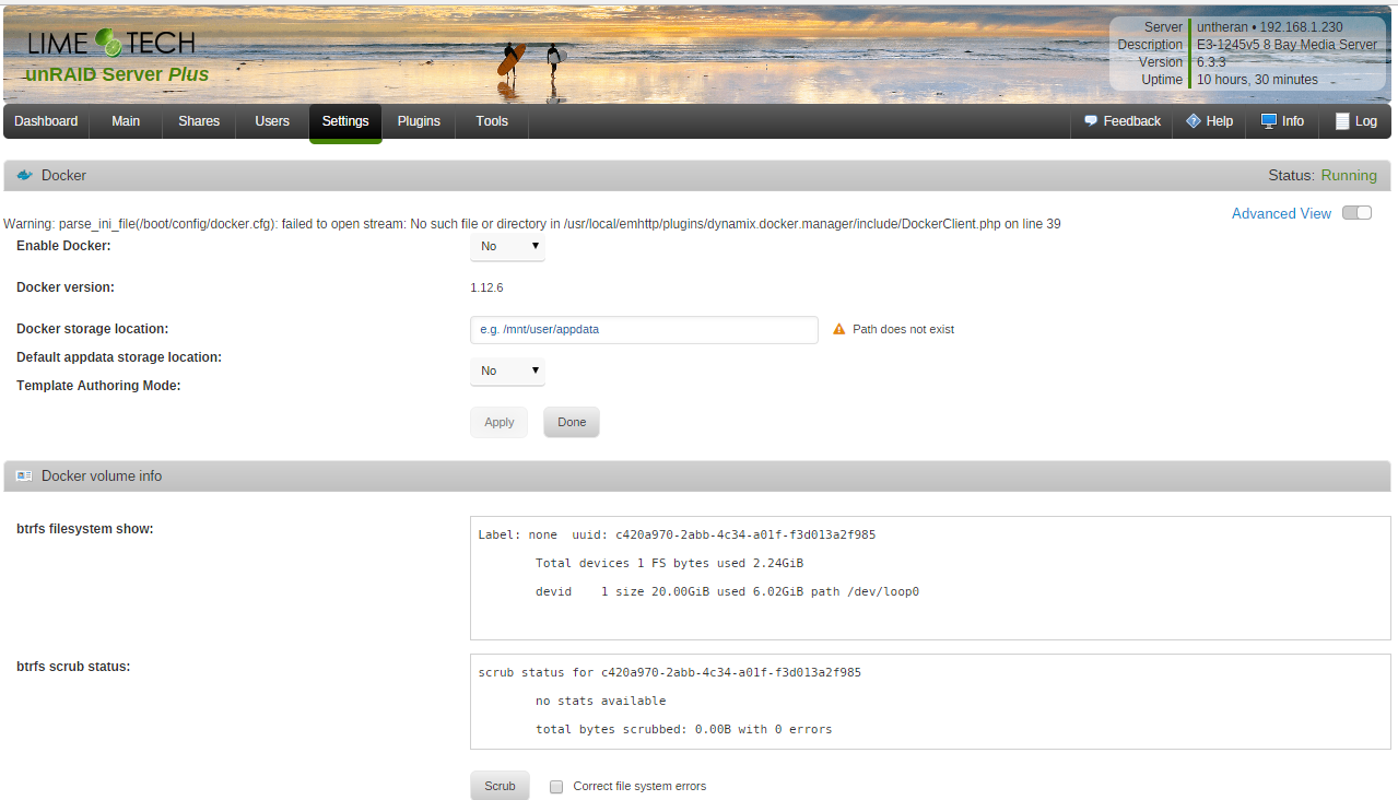

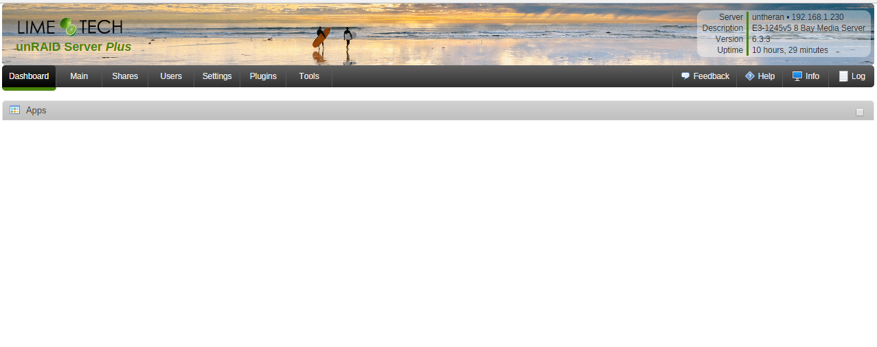

Flash drive is "unmounting"? Dashboard blank and directories missing
I got this issue where the system flash drive seems like going missing : look at the screenshots.
If I restart the server, everything gets back to normal ...

Diagnostics (Tools - Diagnostics, post complete zip) would have been more useful than your screenshots.
Try another USB port, preferably USB2.
I see this in the logs :
Apr 25 01:50:00 untheran kernel: usb 2-3: USB disconnect, device number 2
Apr 25 01:50:00 untheran kernel: sd 0:0:0:0: [sda] Synchronizing SCSI cache
Apr 25 01:50:00 untheran kernel: sd 0:0:0:0: [sda] Synchronize Cache(10) failed: Result: hostbyte=0x01 driverbyte=0x00
Apr 25 01:50:00 untheran kernel: usb 2-3: new SuperSpeed USB device number 3 using xhci_hcd
Apr 25 01:50:00 untheran kernel: usb-storage 2-3:1.0: USB Mass Storage device detected
Apr 25 01:50:00 untheran kernel: scsi host9: usb-storage 2-3:1.0
Apr 25 01:50:01 untheran kernel: FAT-fs (sda1): Directory bread(block 32768) failed
Apr 25 01:50:01 untheran kernel: FAT-fs (sda1): Directory bread(block 32769) failed
Apr 25 01:50:01 untheran kernel: FAT-fs (sda1): Directory bread(block 32770) failed
Apr 25 01:50:01 untheran kernel: FAT-fs (sda1): Directory bread(block 32771) failed
Apr 25 01:50:01 untheran kernel: FAT-fs (sda1): Directory bread(block 32772) failed
Apr 25 01:50:01 untheran kernel: FAT-fs (sda1): Directory bread(block 32773) failed
Apr 25 01:50:01 untheran kernel: FAT-fs (sda1): Directory bread(block 32774) failed
Apr 25 01:50:01 untheran kernel: FAT-fs (sda1): Directory bread(block 32775) failed
Apr 25 01:50:01 untheran kernel: FAT-fs (sda1): Directory bread(block 32776) failed
Apr 25 01:50:01 untheran kernel: FAT-fs (sda1): Directory bread(block 32777) failed
Apr 25 01:50:01 untheran root:
Apr 25 01:50:01 untheran root: Warning: file_put_contents(/boot/config/docker.cfg): failed to open stream: No such file or directory in /usr/local/emhttp/plugins/dynamix.docker.manager/scripts/dockerconfig.php on line 35
Apr 25 01:50:01 untheran root: Warning: file_put_contents(/boot/config/domain.cfg): failed to open stream: No such file or directory in /usr/local/emhttp/plugins/dynamix.vm.manager/scripts/libvirtconfig.php on line 39
Apr 25 01:50:02 untheran kernel: scsi 9:0:0:0: Direct-Access     Lexar    USB Flash Drive  1100 PQ: 0 ANSI: 6
Apr 25 01:50:02 untheran kernel: sd 9:0:0:0: Attached scsi generic sg0 type 0
Apr 25 01:50:02 untheran kernel: sd 9:0:0:0: [sde] 62517248 512-byte logical blocks: (32.0 GB/29.8 GiB)
Apr 25 01:50:02 untheran kernel: sd 9:0:0:0: [sde] Write Protect is off
Apr 25 01:50:02 untheran kernel: sd 9:0:0:0: [sde] Mode Sense: 43 00 00 00
Apr 25 01:50:02 untheran kernel: sd 9:0:0:0: [sde] Write cache: enabled, read cache: enabled, doesn't support DPO or FUA
Apr 25 01:50:02 untheran kernel: sde: sde1
Apr 25 01:50:02 untheran kernel: sd 9:0:0:0: [sde] Attached SCSI removable disk
Edited by Altheran
Try another port for your flash, preferably USB2.
