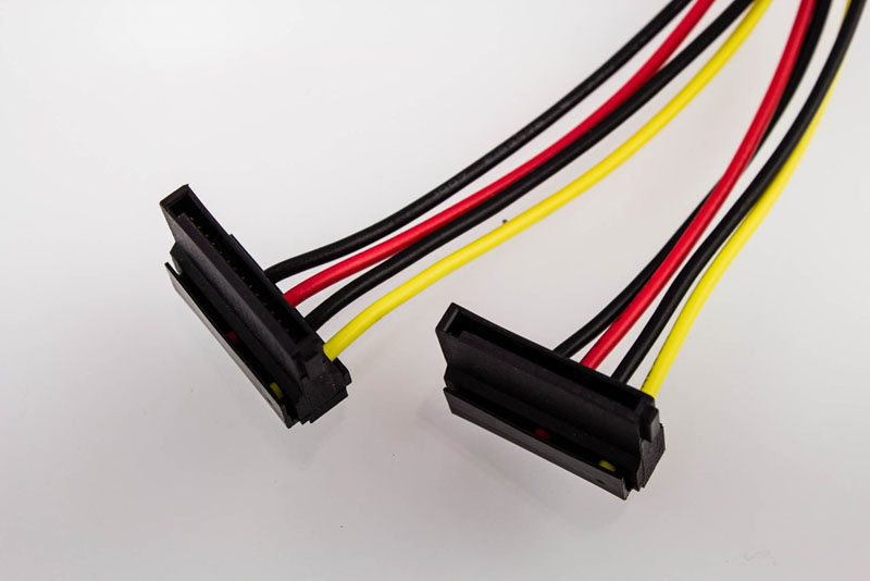

Can you post a Picture of this Cables and/or the SATA-Connector on the Cable?
I had a similar problem in the past and changed all my cables to this connector type and all is fine now.
FYI: This connectors have blade-contacts
