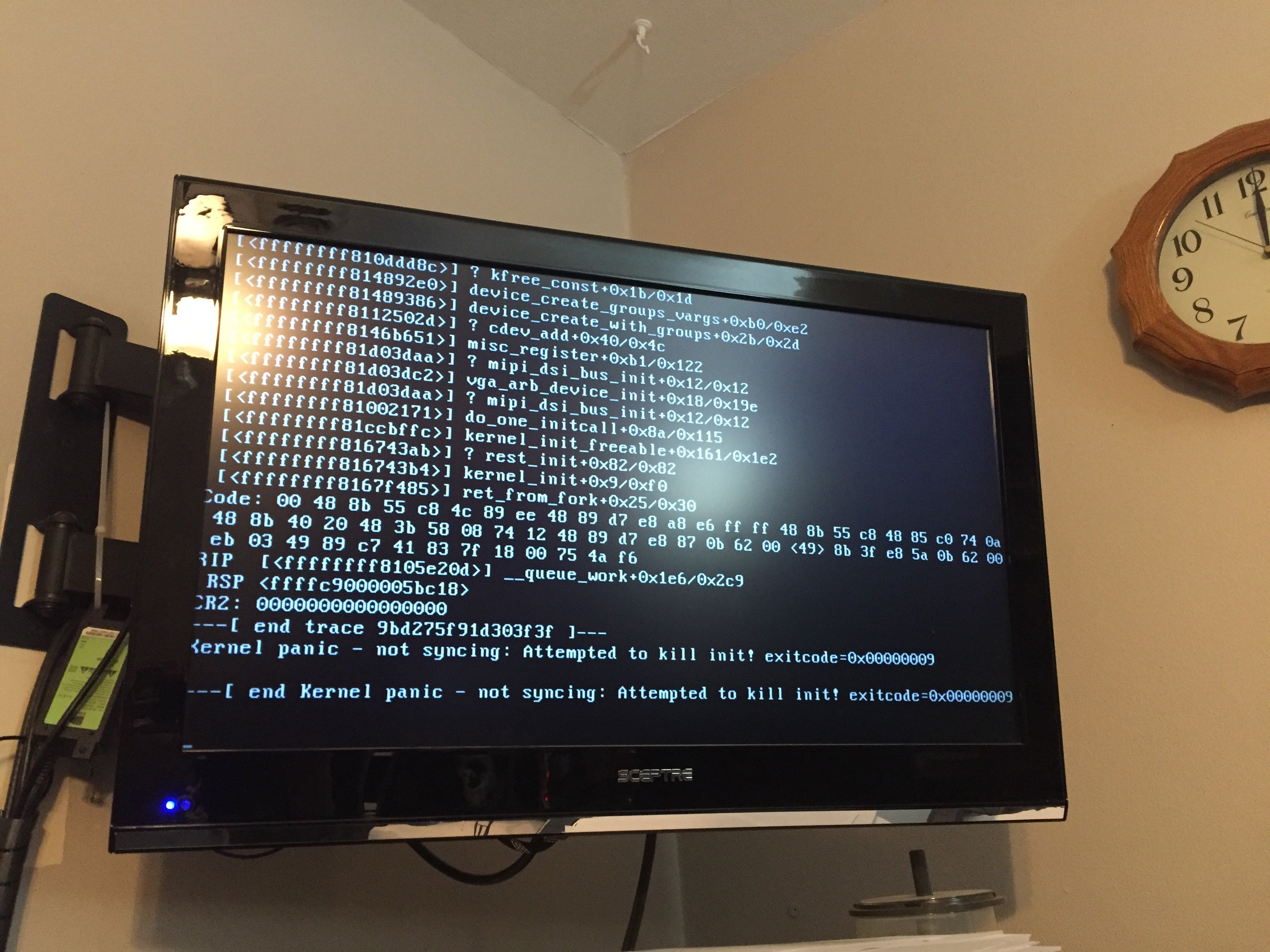

I just did an up date of my plugins including unraid.  Everything seemed to go fine until I did the reboot after the unraid update.  I am getting the error: Kernel Panic - not syncing: attempted to kill init! exitcode=0x00000009
I have had unraid running for a little over a year with no problems.  I did not take not of the versions levels before I clicked on update.  I was probable on v5 because I don't believe I had the ability for dual parity.  When I tried to reboot in safe mode with no plugins I got a message about a recursive error and a reboot was needed.  Rebooting I still come back to the same issue.
How do I recover from this?
If you updated using the GUI you were on v6, try downgrading to v6.2.4, it's still on the download page, probably some compatibility issues with your hardware and the newer kernel, specially if you're using older hardware.
I downloaded the v6.2.4 version and copied files bzimage and bxroot.  system is back up and working.  Running parity check to ensure no data issues.
