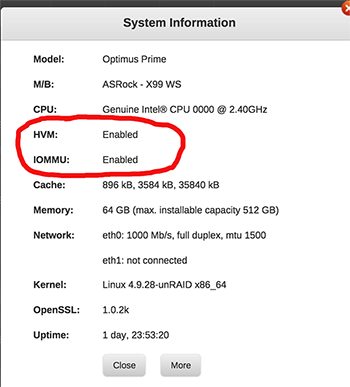

Click on the info button on your unRAID web ui. For passthrough to work you will need to see both hvm and iommu enabled.
5926815284e6b_ScreenShot2017-05-25at07_49_18.png.3f9f064e4100a0815fab3b0f283ac4e4.png
If these are not enabled you will need to check your hardware to see if your CPU supports vtd or amd equivalent.
If it does and you see above this isnt enabled. Then make sure all virtualisation options are enabled in your motherboard bios.

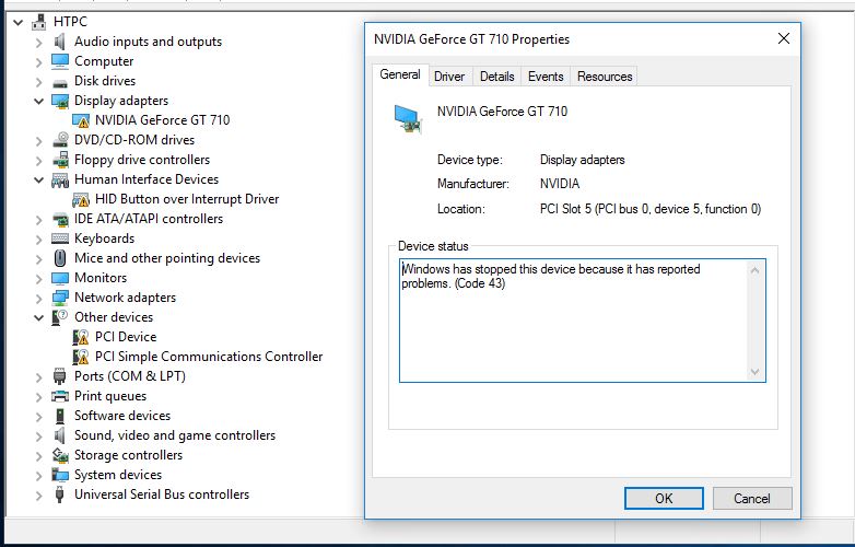

I was able to get the network running. Also I do have HVM and IOMMU enabled. I am able to passthrough the GT 710 fine (I think!!!), but in device manager I see a yellow triangle(screenshot attached) and code 43 and I do not see any video output. LibreElec however works fine and displays video. I have tried installing drivers multiple times in windows10 but no go. Please help!!!
