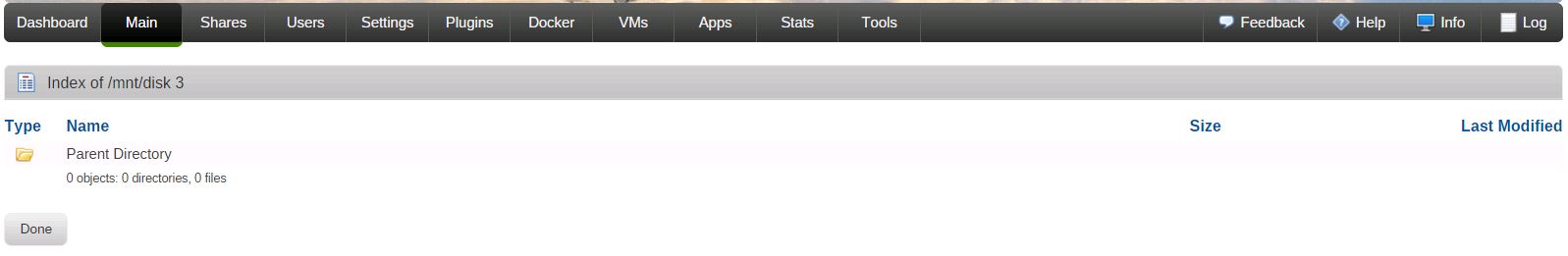

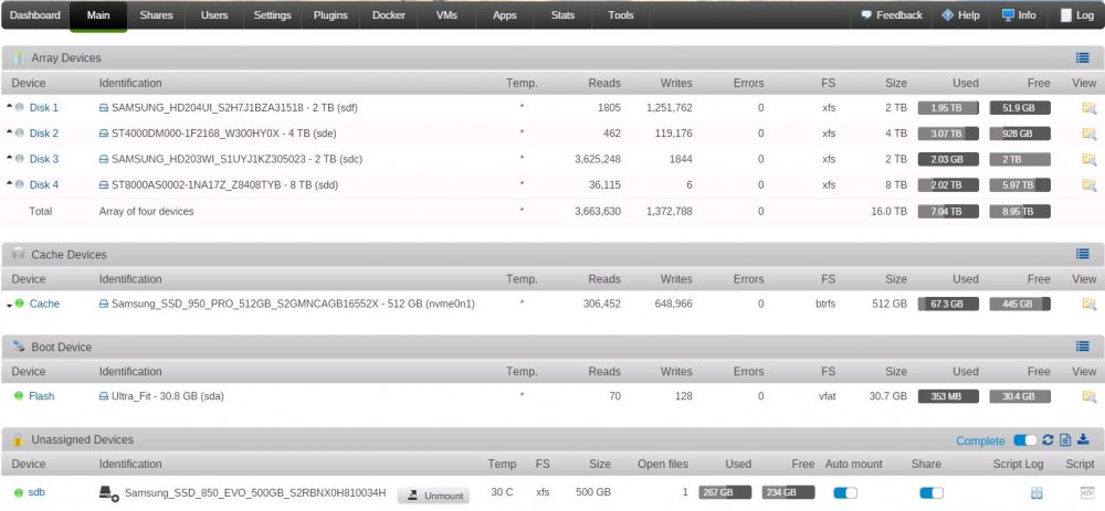

i dont have a parity disk, so i just would like to ask if it is that easy by creating a new config without that disk and remove it then physically.
i moved all stuff from the disk to other disks already, disk is now completely empty,.in my case disk 3.
so now i would follow the instructions by stopping array, create new config, select my 3 disks, start array, prey no data loss ;)

Tools -> New config
You'll need to re-assign the disks you want to keep.
ok, thanks.
retain current configuration, anything i have to declare there ?
As you prefer, you can retain all and unassign the disk you want to remove before starting the array, or retain none and re-assign the disks you want to keep.
ok, so its only pre configed then, thanks alot for your help.
easy as dell ;) thanks, worked without any issues.
