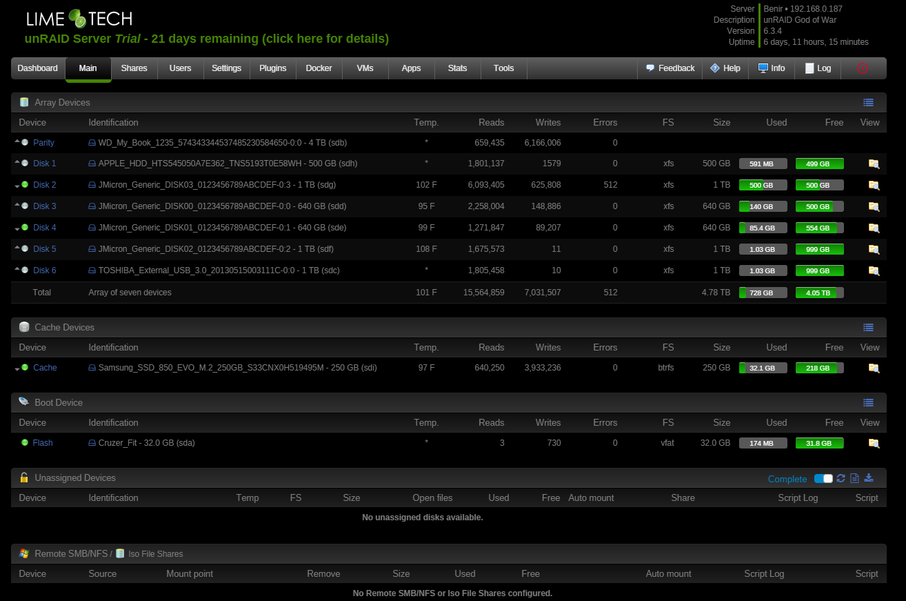

Have been trying unRAID for a couple of weeks now and getting ready to pull the trigger on purchasing when I keep running into disk errors, two separate times, on different disks, but same hardware interface. I would like to figure this out before I continue with unRAID to make sure this is hardware related and not software.
The original errors were displayed on JMicron_Generic_DISK03_* which had a 1 TB drive installed. No SMART errors that I could see, but I yanked the drive from the system since I didn't want to take any chances and was upgrading the storage any how. I didn't think to collect logs or anything at the time. Just the screen shot showing the errors for the disk (attached).
I swapped the 1 TB drive for 2 TB drive in the same drive bay. Just as the parity check was wrapping up from the new drive config, I get another set of errors; same drive bay, different drive. SMART on the new 2 TB drive is showing nothing alarming to me.
I am using a Vantec HX4 connected to a Dell T30 server. It is the Vantec showing up as JMicron_Generic in the logs were both disks have shown errors.
Although USB devices can be used as part of the array it's not really recommended, in part for performance reasons, but mainly because they can be very flaky and error handling is usually much worse than internals, some enclosures are better than others, but you should use SATA/SAS devices only.
