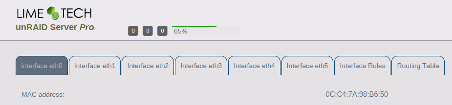

I dont see the Interface Rules option.  When I saw that the option was missing
I'm running the RC series in an unRAID vm, but I don't think that matters.
I did a clean install of RC4, and Interface Rules was not an option in the GUI. No change after upgrading to RC5.  There was no network-rules.cfg in /config, so I brought over a copy from a 6.3.3 system, and edited it to reflect the MAC addresses in the vm.  That caused the GUI to show Interface Rules.  However, after rebooting RC5, network-rules.cfg was gone.  So I assumed that Limetech had removed the feature.

Thought it might be related to the NICs being virtio, so I changed them to e1000, but no difference.

My physical server has 4 NICs and runs 6.3.3.  I'm testing 6.4 RC5 in a vm with 2 nics.

28 minutes ago, bonienl said:
When there is no interface-rules file, it means unRAID doesn't see the interfaces at startup
Could be that whatever function call unRAID is using to query the NICS doesn't work in a vm.
