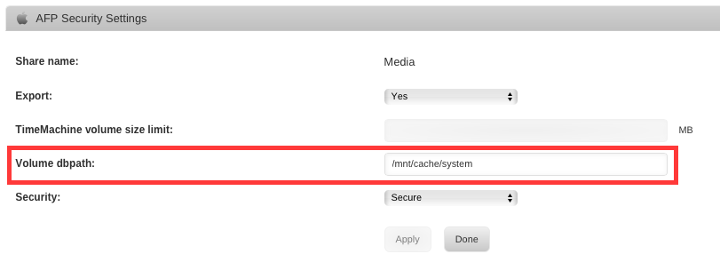

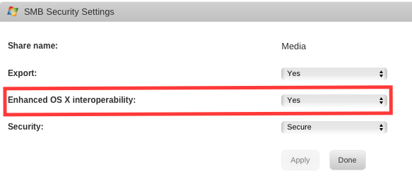

But there are two settings that you could try:
1. For each share under the AFP Security Settings area, set "Volume dbpath" to a cache only folder. This will store some (all?) Mac specific files on your cache drive instead of the array disk.
2. For each share  under the SMB Security Settings, set Enhanced OS X interoperability to Yes. According to the built-in help this should speed up Finder browsing if you're using SMB instead of AFP.
Let us know if either of those works.

Thanks Jorgen, appreciate the reply.
AFP is off (but not sure why, is it better than SMB in a Mac environment ?
SMD Enhanced OS X Interop has always been turned on.
Thanks, Shane
