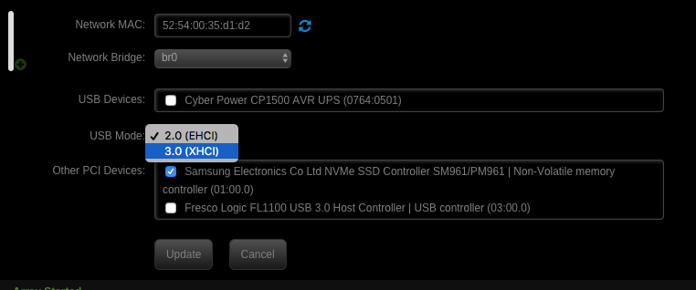

July 20, 20179 yr seems like some usb issue. Try changing the usb type here. Also try plugging in the usb keyboard mouse in a different port on motherboard. If that fails probably passing through a usb controller to the vm will work fine but is more complicated to set up
July 21, 20179 yr Author @gridrunner Thank you. I passed a USB controller to it. All working well now. Thanks for your videos. I've found them very informative
