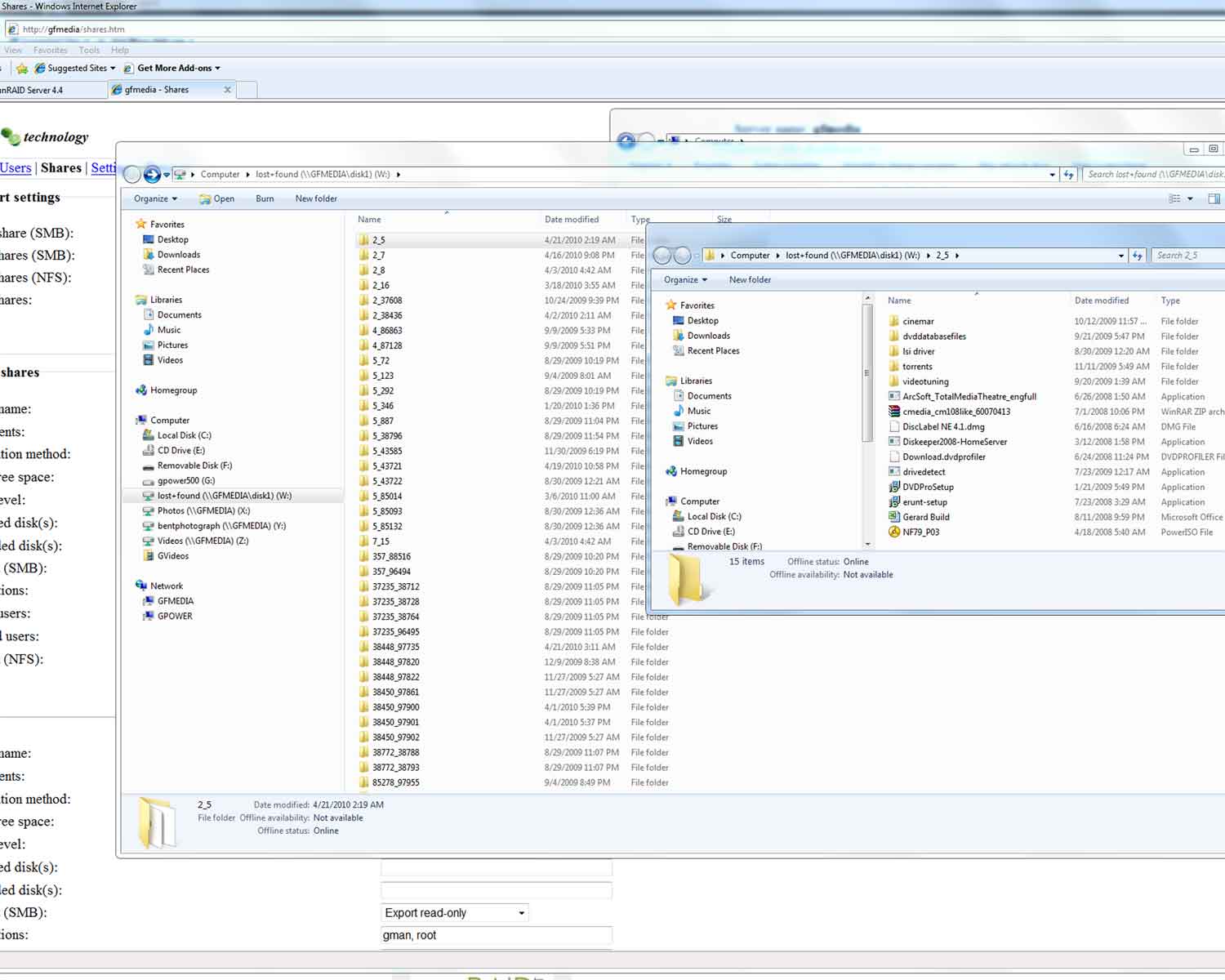

OK, I exported Disk Shares and was able to see the Lost/Found folders, like joe mentioned.  Large folders - lots of data in them.  Attached screenshot of one of them.  I guess these are just 'misplaced' folders that need to moved to their respective shares.  I only have 3 main shares - Movies, Photos and Work - so shouldnt be too hard to drag and drop accordingly.
[/img]
Ok, I got your message after I posted my last one regarding how I navigate to the Lost Found folder.  So if I am reading you correctly, your suggestion is to NOT use user shares via windows explorer...rather to use mc (i am familiar with that program) via telnet and get things properly placed/mapped that way.
I am finding that, depending on how user level was split, using explorer is going to be more difficult that I originally thought.  If I had split level to 999, I could potentially find a lot of various files in all sorts of places.  For movies, I think I should be OK because I had that split to 3.  Photos might be a different story.
So, following your recommendation, use MC - and dont export user shares at all...for the time being.  Ill go with that.  Ill run parity once again after I get through a whole disk.  Might be a few hours or more.
If you use user-shares, unRAID may decide the best place for a directory is a different drive than it is currently on.  That will take a LOT longer than moving a directory on the same drive (basically instant)
For that reason I do not think using user-shares to move things from the lost+found folder is a good idea.  Use the "disk" shares. You'll get everything back into place a lot more quickly.

So - just want to be completely sure.  I understand what is being recommended as far as using disk shares.  Does that mean I should go into the config and actually disable user shares?  Or simply do not export them?  I dont know what the ramafications are of disabling user shares - since my file structure was based on user shares originally.
A bit confusing because each drive now has a Lost/Found folder.  If I look at my user shares, it shows approximately 50% of original data in its original location.  So take disk1 for example, I have a Lost/Found folder there with tons of randomly named folders.  By opening each one, I can see what data is inside - Movie/Photo/Music.  So say its a Movie file, I dont know what drive it originally was in, because it was based on user shares.  It could have been any of them.  I could point it towards the user share, but thats what I think Joe was referring to as far as taking much more time and not dealing with user shares for the time being.  I dont have a problem with that, but I think I must be missing somethign because there is no way to determine what disk a folder/file should be on, unless a completely new remap is in order.
The only thing I could think of is to actually DISABLE user shares, and go with Disk Shares, and actually remap everything acccording to disk shares. ie: Ill say I want all movies to be on disk1, create a folder on disk1, and then move everything I find there.  Then create a folder for Music on Disk2, or whatever.  Essentially a complete remap based on disk shares.  Is that correct or am I completely missing something here.
