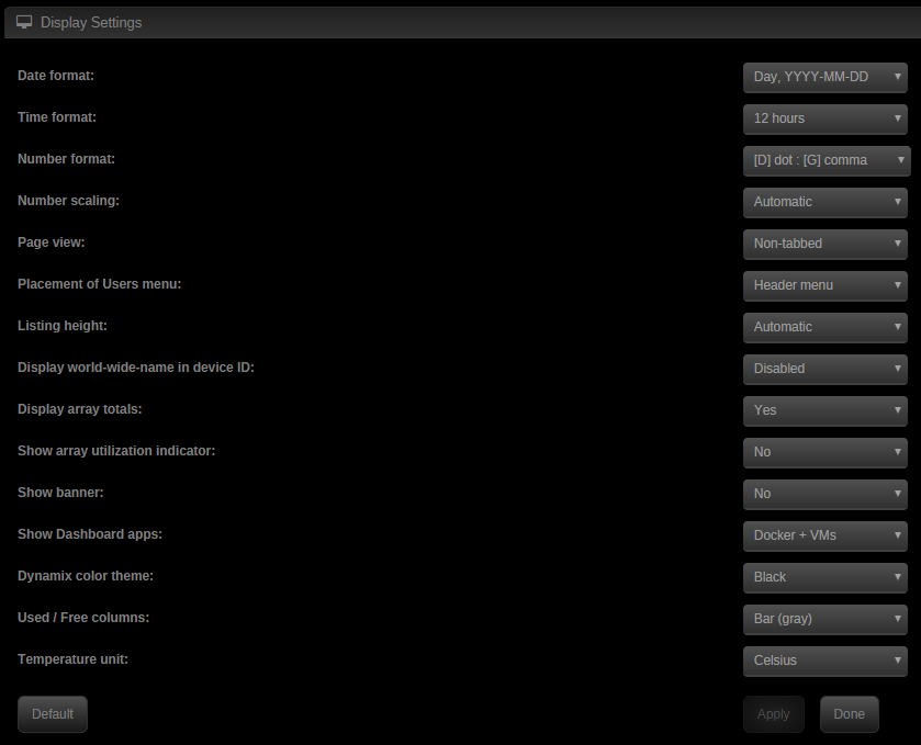

The webUI is updated on its own schedule.  Settings - Display Settings - Poll Attributes.
I dont have that...
My bad.  I'm AFK.  It'll be Settings - Disk Settings
ok I set it for 60.  But its still showing spun-down while if I run the command its showing active/idle.  Something is going on there.
