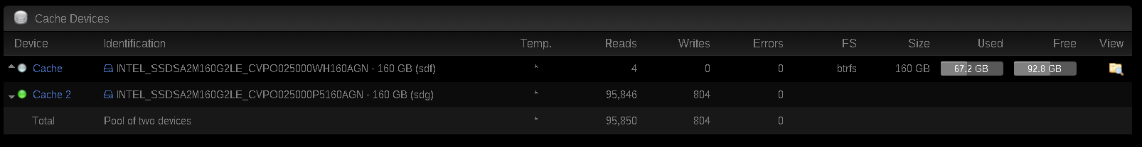

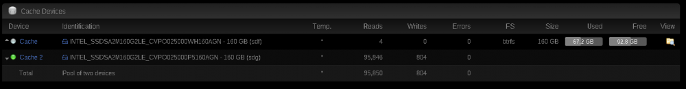

SSD cache pool only utilises 1 disk?
See attachment for details.
Is what is shown in the attachment normal?
I would suspect, because there are 2 drives, that raid 1 would be used; and so both drives should have identical writes/reads?
Looks like only one is being used, post your diagnostics.
Change you cache pool raid settings. Easy fix

The diagnostics confirm only one device (cache2) is being used, this should fix it:
-Backup your cache in case something goes wrong
-Stop the array
-if you rebooted since check that cache1 is still sdf and wipe it using:
blkdiscard /dev/sdf
-on the WebGUI click on "Main", cache1 SSD icon should turn blue
-start the array, a balance will begin and when all cache pool read/writes stop the pool should now be using both devices.
You can post new diags to confirm if unsure.
Both are being used now but it's not balanced correctly, on the main page click on "cache", then on "balance status" paste in the options:
-dconvert=raid1 -mconvert=raid1
Then click on balance.
It is balancing now. thanks again!
