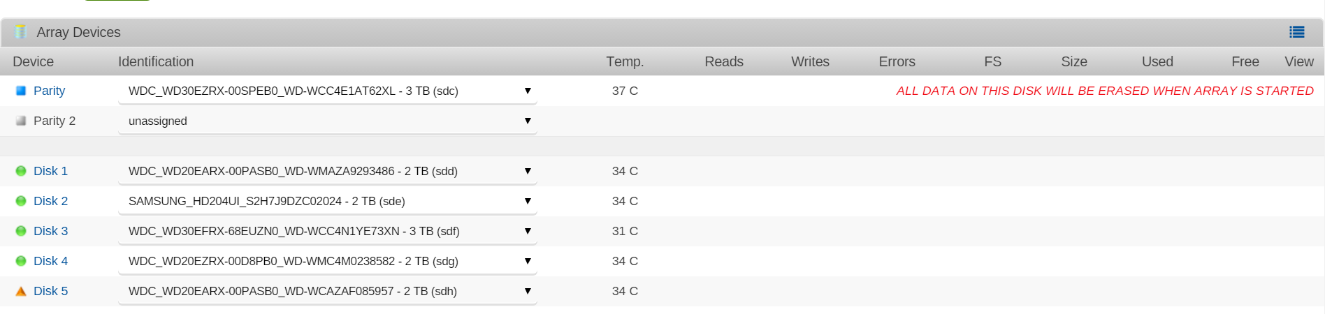

i popped out and re-seated my parity drive and rebooted my server. Now it has a warning "ALL DATA ON THIS DISK WILL BE ERASED WHEN ARRAY IS STARTED"
i am scared to do this because I don't understand how unraid could rebuild my parity when my disk5 is already being emulated. Any suggestions on how to avoid data loss would be much appreciated...
Assuming parity is still valid you can do this:
-Tools -> New Config -> Retain current configuration: All -> Apply
-check both "parity is already valid" and "maintenance mode" before starting the array
-start the array
-stop array, unassign disk5
-start array, check emulated disk mounts and contents look correct
-stop array, reassign disk5
-start array to begin rebuild
