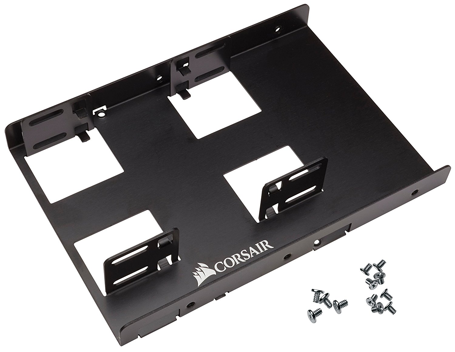

For best results, I would recommend matched pairs of SSD if possible. This will give you RAID1 redundancy. One disk by itself has the potential of going bad and losing anything on it (Dockers, vms, data waiting to be moved to the array, etc.).
If mounting spots are scarce (as is mine), consider one of these dual SSD mounts. I mounted it to the back of case using regular PC screws through the airflow venting holes (turn it up on end and line up screw holes).
https://www.amazon.com/Corsair-Dual-Mounting-Bracket-CSSD-BRKT2/dp/B016498CK0/ref=ya_od_pd_dx_gc_1?_encoding=UTF8&pd_rd_i=B016498CK0&pd_rd_r=SX4WTN52SCYY1A3ZQPE1&pd_rd_w=tZnnn&pd_rd_wg=IHwmS&psc=1&refRID=QAJA513ZS9C9B62M4ZFA
Yep have a couple of those I have a total of 4 factory slots for 3.5 drives with only 3 sata ports and I have 1 pcie x1 with the cache drive on it, it also has a sata connector to add a drive off the card for a total of 5 drives but that's a good idea didn't think of that I have quite a bit of unobstructed space as its a pre-built so you can imagine there's not much in there although it is an i7 6700 w/16gigs of ram :D I'll have to look at the specs on my raid card that has a 4 cable break out but I might be getting close to the psu threshold as its only 350 watts.
