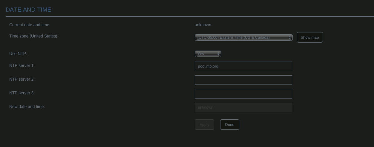

August 23, 20179 yr had problems last week that have been resolved. link below. have a new Nic installed and everything is running great but I saw in logs something about a npt threshold error or something. looked at date and time in settings and says its unknown. if I ssh into the machine and the date command returns the correct date and time. Also then saw a token error for a dynamics plug in. Before I copied them, they went away but attached are my logs. Thanks tower-diagnostics-20170823-1915.zip
August 24, 20179 yr Author think the token error is nothing but would like to know why its settings is telling me unknown date and time but logs and everything else is fine.
August 24, 20179 yr Do you have internet connection? Try: ping pool.ntp.org Ps. you may include more NTP servers (can be again pool.ntp.org) Edited August 24, 20179 yr by bonienl
August 24, 20179 yr Author wow. anything i ping is coming up to weird ips. i am not at home so i can't check the pings from a different computer. the gui web browser on the server had no problem getting out. I cant even ping google.com correctly.
September 5, 20179 yr I've made an update to the plugin and replaced the deprecated time variable of emhttp.
