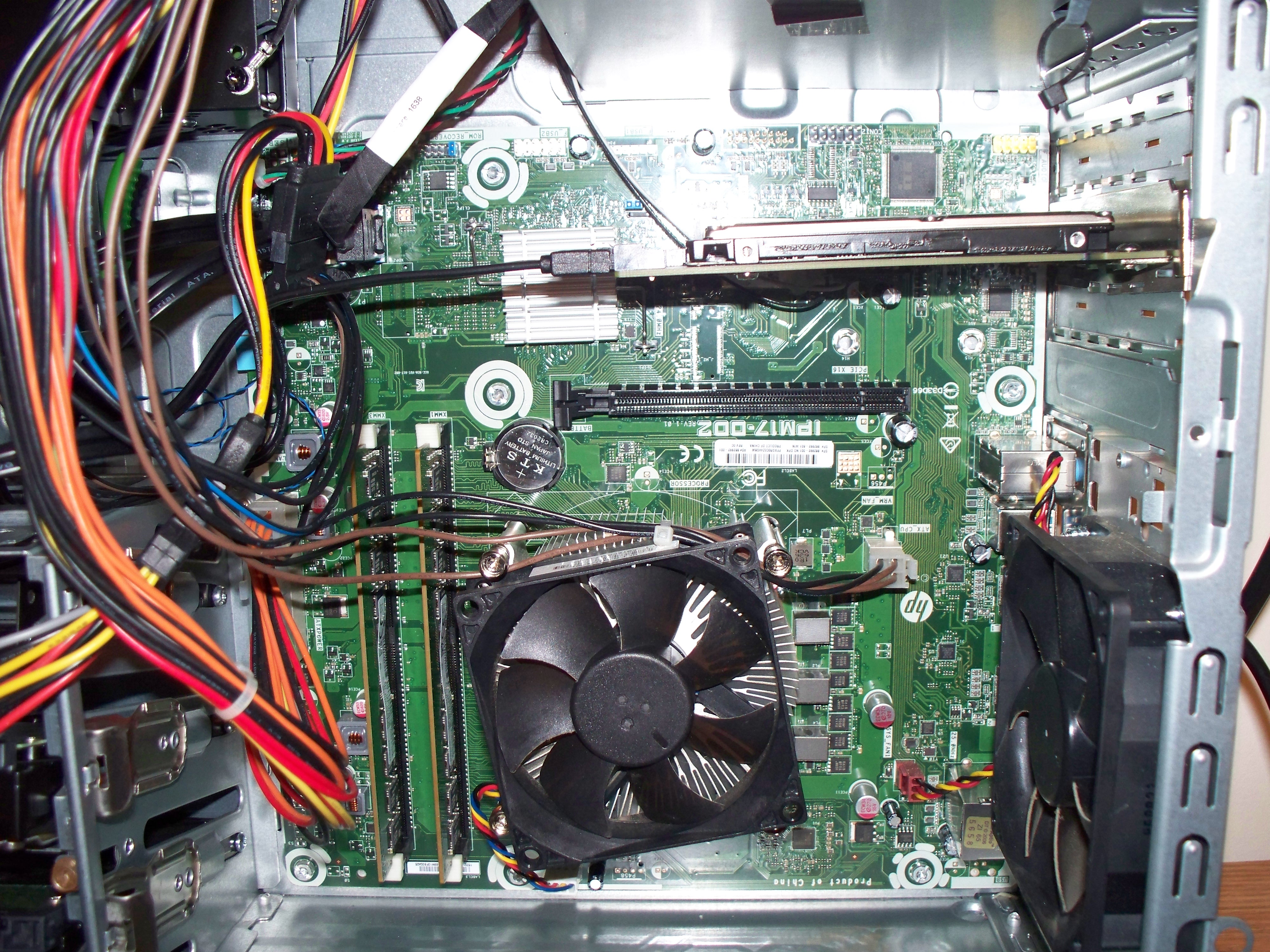

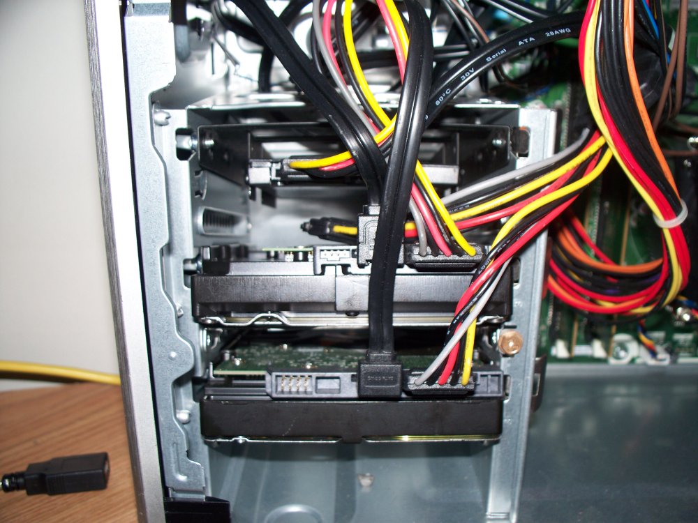

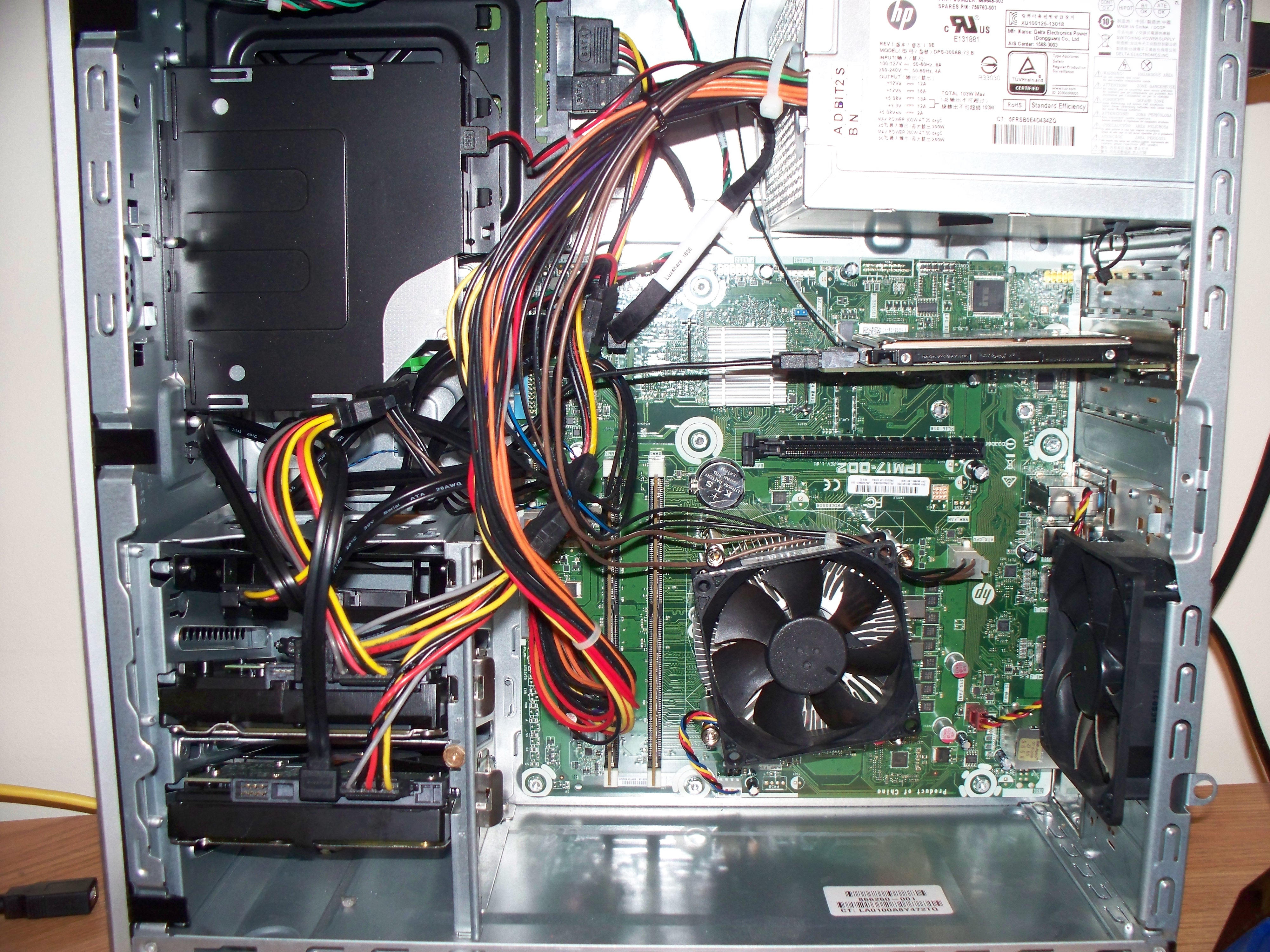

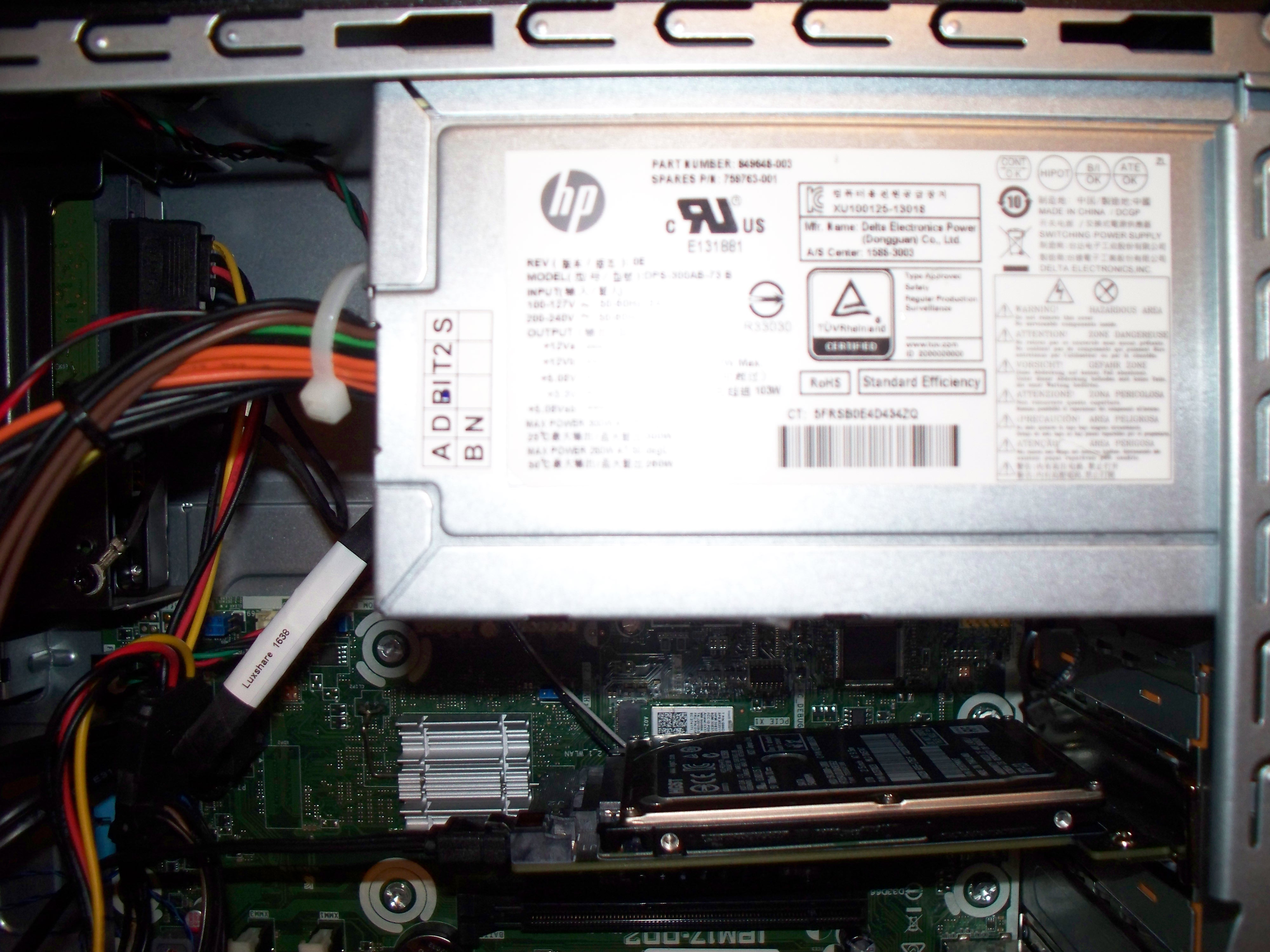

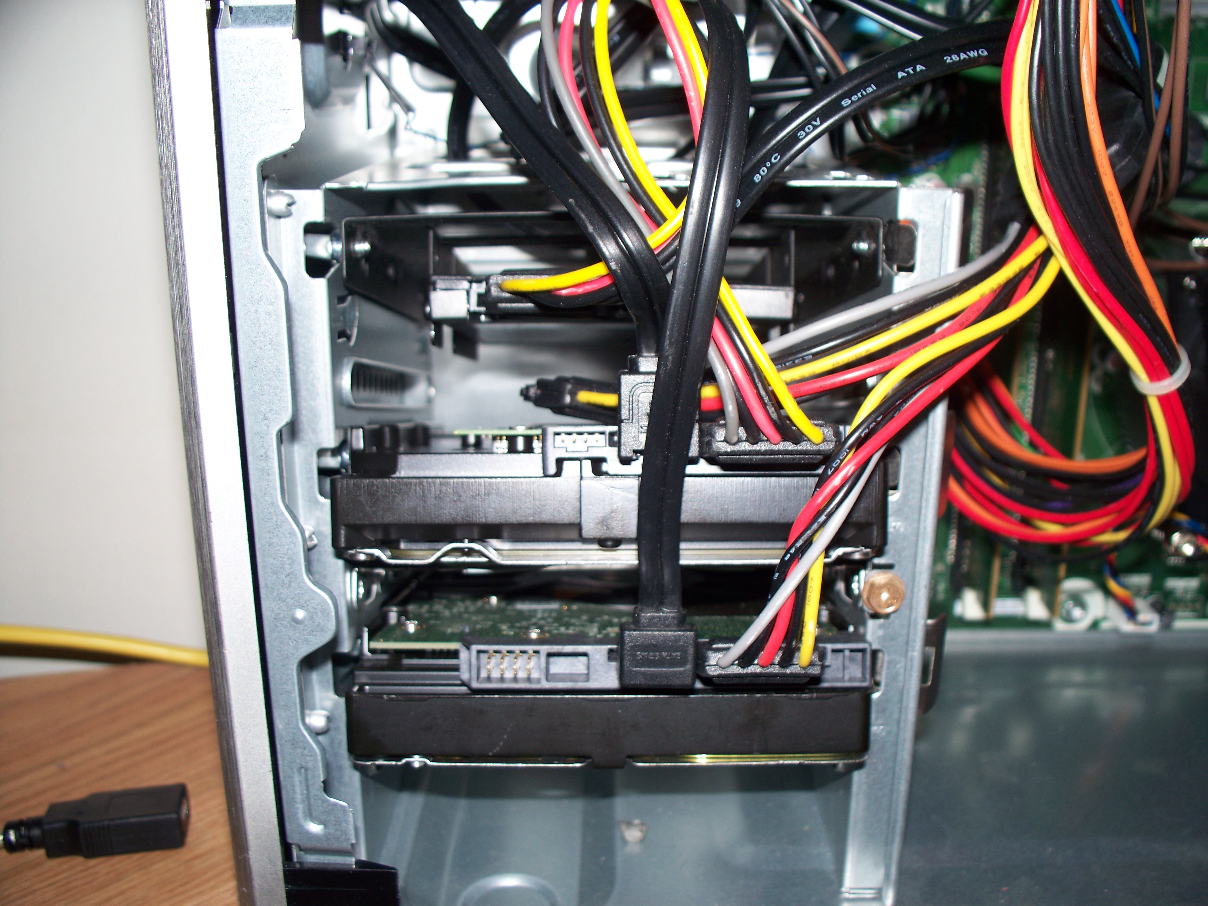

August 25, 20179 yr Author These may shed some light on what I'm dealing with, not sure if you can tell but when I was stripping it down I took the front panel off and low and behold there was an additional 3.5 inch bay hiding behind the cd drive so in theory there are 4 3.5 inch bays and then whatever cards I have installed but as a pre-build it only has 1 x1 and 1 x156 slot so not much headroom for expandability. oh and notice that the board is on the opposite side of the case from the norm! Edited August 25, 20179 yr by mrbilky
August 25, 20179 yr So if you were to put in a basis SAS HBA, you could hookup all the drives you wanted And if you really want more capacity you could use 4 standoff screws in a HDD and mount it at the bottom too. 2.5" ssd's love being put just about anywhere too, plenty of spots hide them away Sent from my iPhone using Tapatalk
