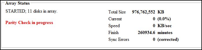

It will speed up once it gets past the 1TB drives.
But if you want, you can rejoice that your display does not look like this:
