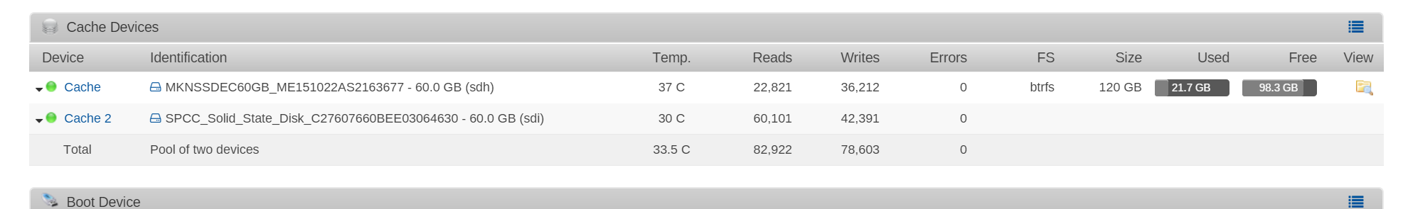

So that seems to be good news.  However, See the attached screen shot.  I have used 20 GB of space and have a pool of two 60 GB drives.  It used to show 60GB of space because the pool is mirrored.  However, it now shows 120GB of space.  Have i lost the mirrored drives?
Also, there is a "check file system status" as well that requires maintenance mode.  What is that?  (for future reference if not now).
