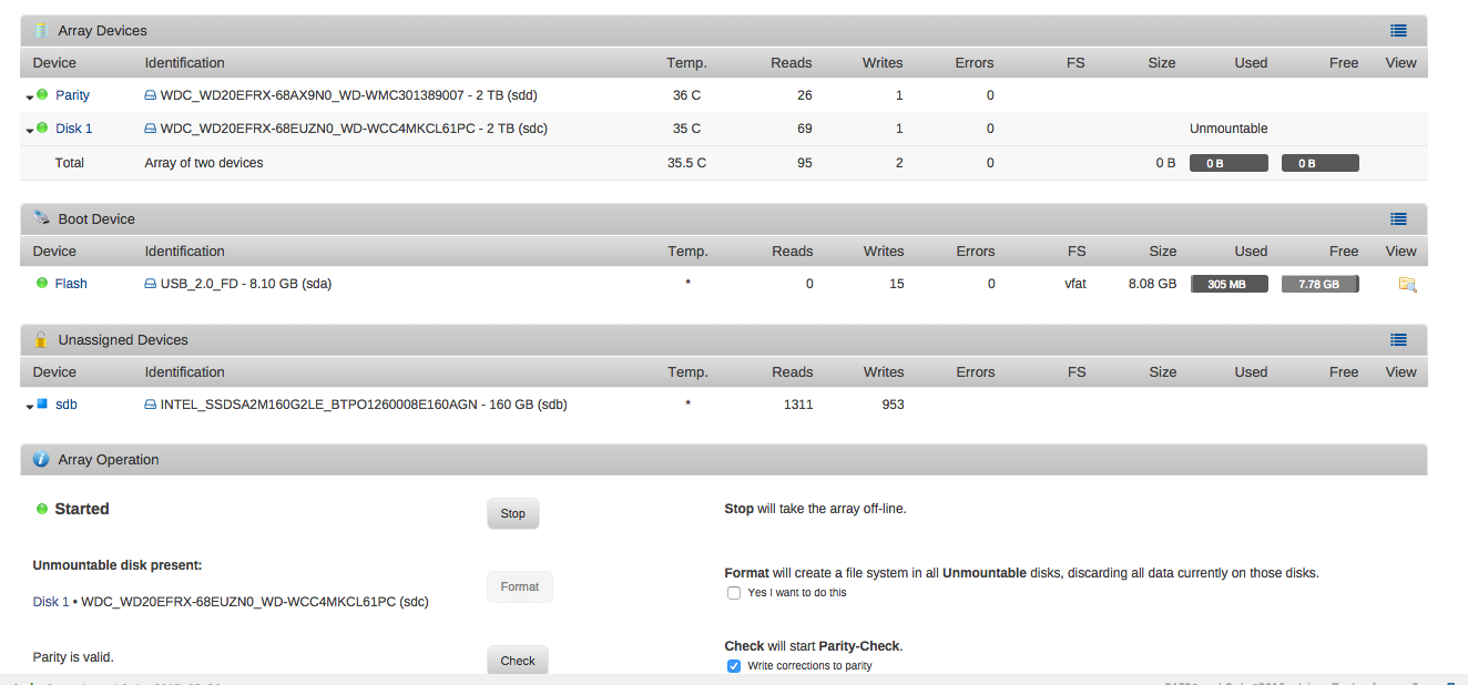

Attached is main screenshot and diag

Whatever you did to end up like this I don't see how you can recover the data, there's no a valid superblock, without it the disk won't mount, also xfs_repair can't even find a backup superblock, maybe a file recovery program, but if there are no superblocks I doubt there's any data.
